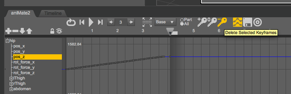

Within aniMate2, you can use the graph editor to remove the z translation.
If you have baked to Studio keys, select the joint to remove z translation (usually the hip), then Alt+click on the Z translate slider.
To delete inside aniMate2:
The graph editor is the icon highlighted on the right.
Click the pos_z on the hip, then click the - key icon, and delete all keyframes in the block that way.
