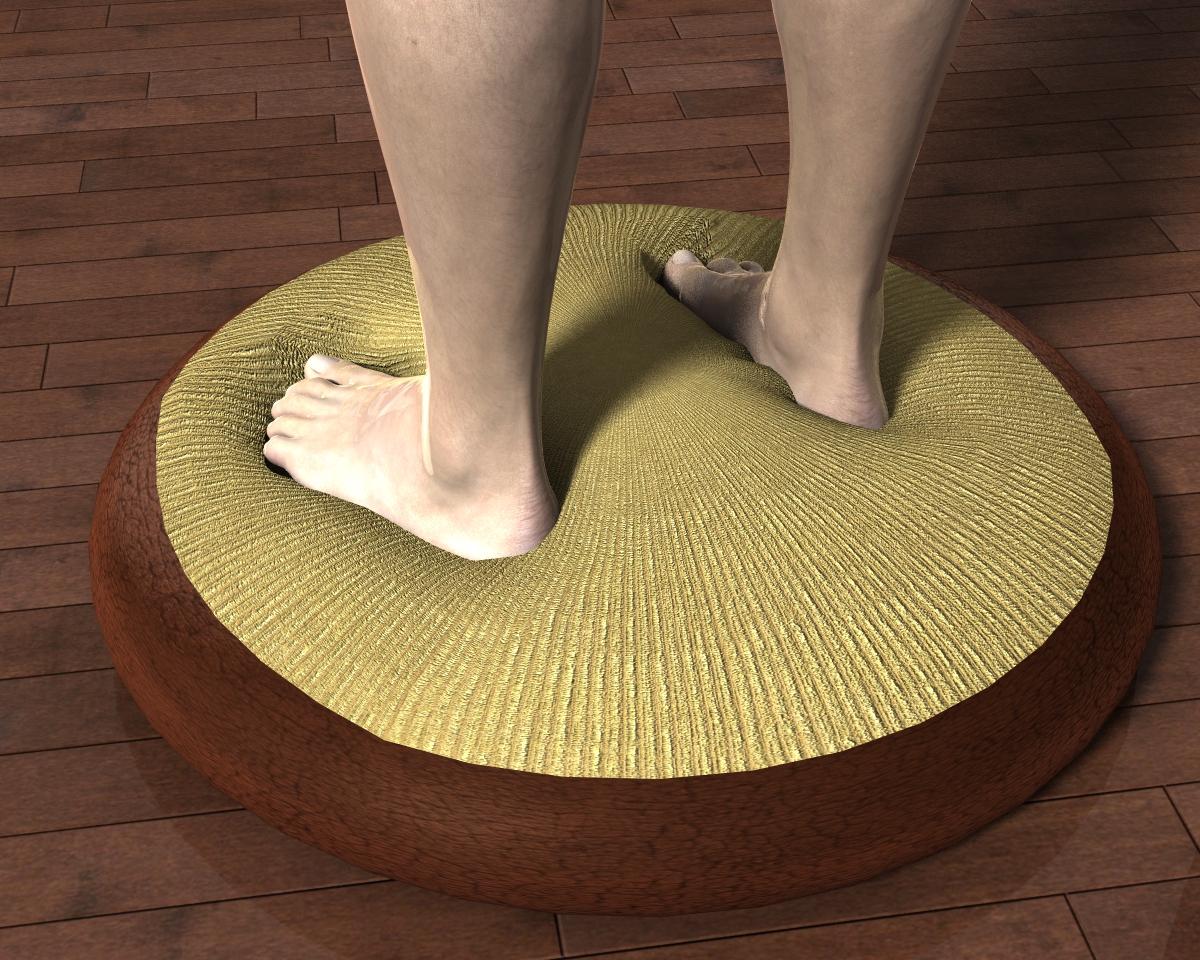

    Here's the pillow I posted previously projected into a cube. The pillow is just a squashed sphere. You can see that the edges have transformed into a rounded rectangle. The circular surface (yellow) does not distort because those vertices were not affected by the projection.
    After playing around with the reprojector for some time, I stopped trying to use it as the results were too hit or miss. The feet on the pillow turned out good but I could never get a person sitting to work all that well. The pillow would distort but not in ways that it would in reality.

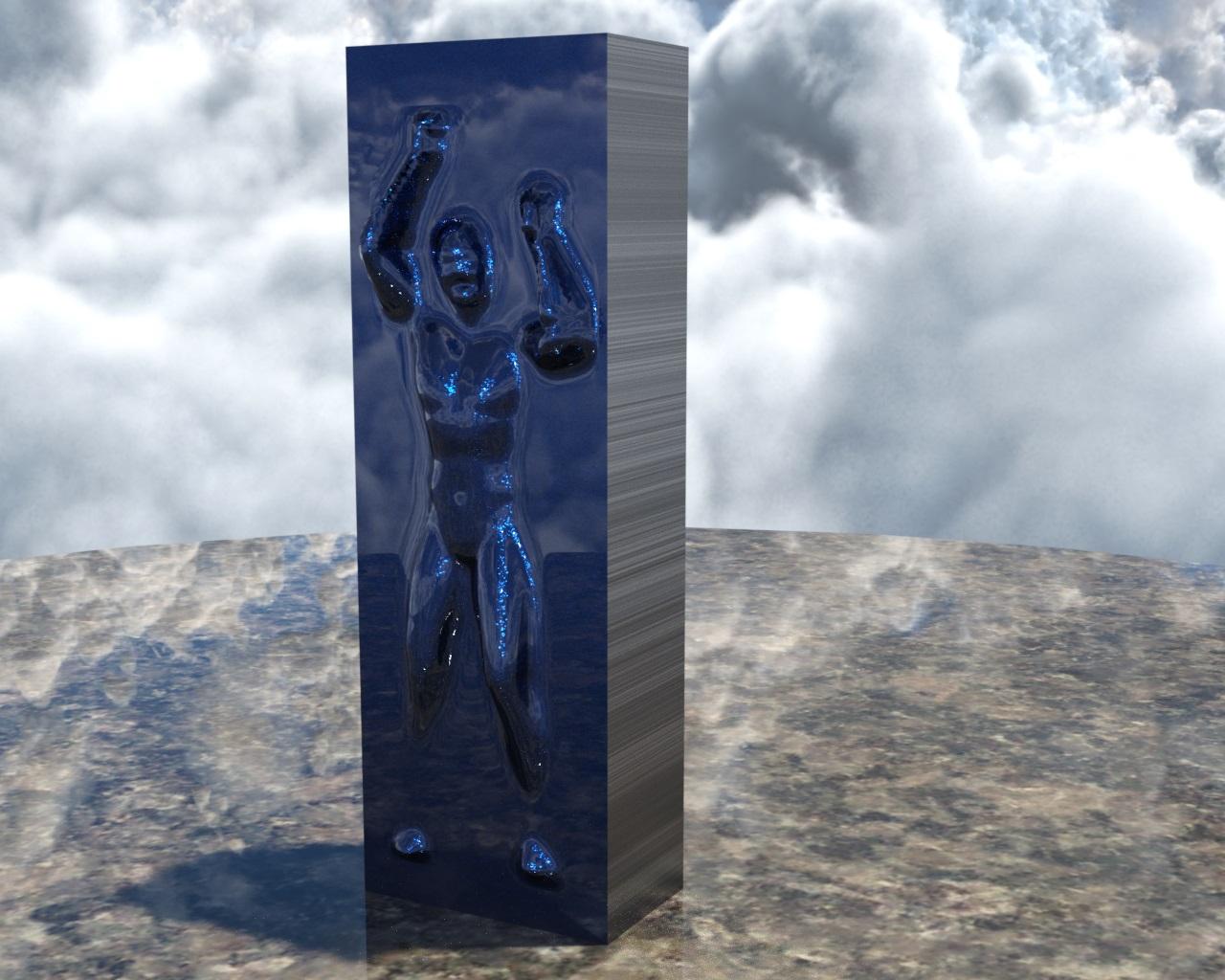

    Ok, below is my attempt. I have used RGcincy settings. Dark Forces has frozen Leo into the block of carbonite.

    Nicely done, Artini!!!
