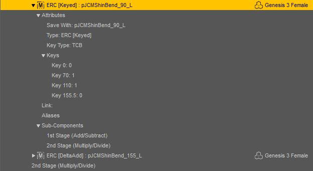

I understand what DeltaAdd and Multiply are for, but what is the purpose of Keyed and how does it work.
Here is an example from a snapshot of the parameter hierarchy. This is a correction for a joint bend. What do the keys mean and the key type TCB?
624 x 341 - 24K
Post edited by Singular3D on
  • Richard HaseltineRichard Haseltine Posts: 111,965
    Keyed ERC allows you to have a non-linear relationship between controller and controlled - for example with a joint and a JCM the JCM might be set nott o kick in until the bend hit 20 degrees (when the leg met the skirt say), then turn on in a series of icnreasing steps as the limb continues to bend. To set it up, set the vlues for the controller and the controlled properties at keys ibon the timeline (set both to 0 at frame zero, then move forward and set the bend to 20 and again the morph to 0, then go to 40 and set the morph to .2, etc.): once the sequence exists on the timeline use ERC Freeze as usual and check the Keyed (Extract from play Range) box.
  • Singular3DSingular3D Posts: 676
    Thanks, that makes sense to me. Seems that I slowly begin to understand the technical details of Genesis 3 and Daz Studio.
    So in the example above the morph will be zero at 0 then rise linear to 1 at a value of 70. Stay at 1 up to 110 and then fall linear to 0 again till 155.5
    Yes, that sounds right.
