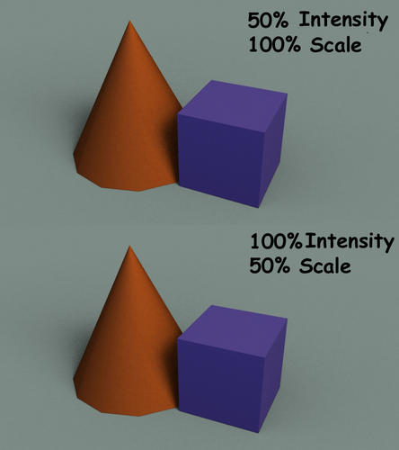

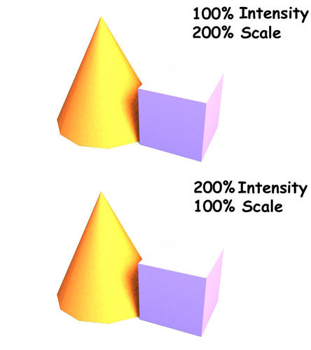

    I must admit the Intensity scale has alluded me, well the reason it is there has. It did some tests a while a go and to be honest from a Viewport difference I see no difference in render, as shown below. What I mean about seeing the difference in the viewport is that when you adjust the Light Intensity you see a visual difference in light in the scene. When adjusting the scale you don't see a change.
    These 4 images are just made up of 3 primitives and Uber Outdoor Preset at the highest quality preset. Render quality low for quick rendering. As you can see the is no difference between the two pairs of images. I can use IrFanView to view image and I go flip back and forth and I see now change what so ever.
    This is why I have no idea why it is there and have been searching for the answer for a while. :)

    No adding another light source would deteat the purpose and not give the a clear indication on what Intensity Scale is for, that is why I didn't put another light in. Adjusting the scale won't effect other lights in the scene so I can't see it making any difference..
    Also using an Intensity scale of 0% effectively turns off the light. I just tested it and it rendered totally black.

    Final light color = Color * Intensity * IntensityScale.
    Yes, it is a little redundant, but the main reason for the adding the control was to more easily allow for intensities > 1.

    My advice is anything lower than 100% intensity use the to main Intensity slider. The Intensity scale is handy when or if the need arsies to go above 100% intensity without blowing out the scene with light while building it.. ;)
  • Judging by the example picture posted by Szark, it would appear that intensity and intensity scale are multiplied to give the total light intensity. Therefore swapping their values would have no apparent effect upon a render. Intensity scale is a scalar whereas intensity is a percentage. So the final light output level is likely given by the formula: total light output = lumens x (intensity/100) x intensity scale. After that its modified by a distance falloff (how sharply it drops in total output over distance) and is multiplied by the surface color of the material, the dot product between the incoming ray and the face normal etc...
