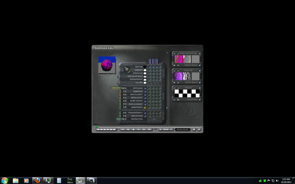

    The three channels can be used independently as needed. However, there are times when you may want to do a combination of textures. In such a condition you must assign one texture to Channel A, another to Channel B, and a third to Channel C. Channel C is used to dither the results of Channel A and B.
    In the sample below you can see how there are two distinct textures in Channel A and B and how they are dithered by Channel C.
    The "white" in Channel C corresponds with Channel A
    The "black" in Channle C corresponds with Channel B.
    This creates a checkered pattern.
    If you place a neutral gray into Channel C it will blend Channel A and B each at 50% opacity. Hope this explains it more or less.

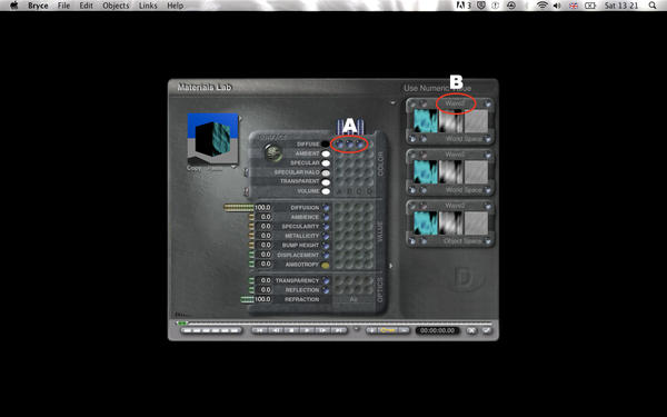

    Enter the Mat Lab and press 'control' whilst creating a blob in channel A then drag across so the blob also fills in channel B and C (first picture below outlined in red marked A)
    Three mini previews are now available in the right hand section.
    Click 'Shift' whilst clicking on the title at the top of the mini preview (first picture below outlined in red marked B)

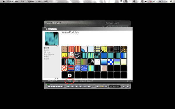

    This will open up your basic material library.
    Choose the material you wish to work with (second picture outlined in red marked C) then hit the tick to confirm.
    Repeat with channel B and C
    You now have all three channels containing the same material (though why you'd want to do that is beyond me). :-)
    If the material you are wanting to use isn't in this library, simply select an object that has the correct material and go to the Mat Lab, then do basically the same thing by clicking on the mini preview title bar while holding the 'shift' key down and in the library window, click 'add' (second picture outlined in red marked D) as you would to add anything to any of the libraries. It will now be there for you to use at any time in the future.
