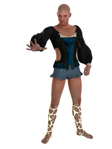

    11. Now you should be able to fit Victoria 4 clothes to G2M with autofit. As usual with autofit, the results may vary and custom bones such as skirt bones, as well as long sleeves, long skirts, high collars, etc, might not autofit well; some minor pockthrough also possible.
    Pictured: G2M wearing V4 Archer top, Anjiru bottoms, and Classic Fantasy jewelled shins.
    696 x 928 - 127K
