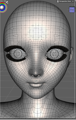

    ok...
    I must have been wrong somewhere but, it worked on one of the 2 eyes... So let's find the error:
    677 x 608 - 344K
  • siocsioc Posts: 334
    edited September 2013
    Yep I forgot to remove the last range of vertex...
    after xy and scale adjustment, my aiko 3 morph on G2F is just great.
    See :
    637 x 999 - 662K
    Post edited by sioc on
