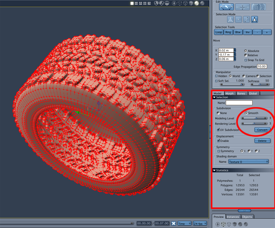

    13K for a model with that detail isn't all that much - could you give a solid wire view and an explanation of your methods which would help us possibly give you a more efficient method?
    I see you often refer to using level 3 SubD - I feel that is a bit excessive - with good modelling techniques, you shouldn't need to go higher than level 1, possibly 2 at the most - maybe that is the problem.  Bear in mind that each level quadrupels the polys.
    Very nice moel, though:)
  • otodomusotodomus Posts: 332
    Thanks Roygee, what I do is to model a segment of the texture thinking in the SubD smoothing step, then I do duplicate the amount necessary to get the size desired of the tire, I had to add a couple of loops to do smoother the texture.
    And when I talk about the SubD to 3 I am referring to the smooth tool, I never hit the convert button this way I never increase the polygon number, is this correct? I do use only the SubD to get the rounded parts on the models:

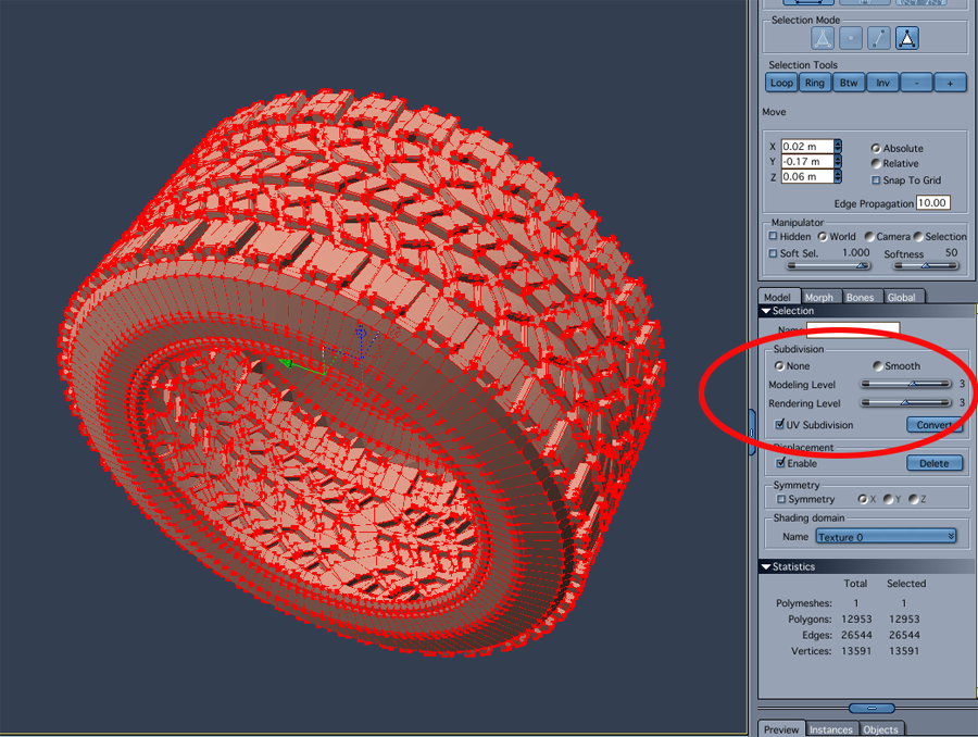

    The last picture was with no SubD smoothing and the following is by applying it, notice how the number of polygon are never increased only get smoother:
    Regards!
    Otto
  • VarselVarsel Posts: 574
    Regards!
    Otto
    Thats true, until you get to the rendering.
    Then the render engine will have to honnor the subdivision and the render time will increase.

  • RoygeeRoygee Posts: 2,247
    Yes, that smoothing is a rendertime effect - it actually increases the poly count at render.  No problem if it's just the one tyre, but when you add to that three more, plus the car and everything else, it becomes significant.  With something that well constructed, I doubt whether there will be that much apparent difference if you only did one level of smoothing.
    You didn't say how you got it to bend in a circle - I'm assuming you used a modifier?  Have you tried using the replicate function under the edit menu?  It gives three options, linear, array and circle.
    What I would do is model one half of the profile, do an array replication in a circle on the X axis, then duplicate with symmetry on the Y axis. These functions are pretty fiddly in Carrara because you don't see the result until you commit - so you have to do it on a guess.  If the result is not to your liking, you undo and try again, but still more efficient than copying and bending.
    Regards!
    Otto
    Statistics in Carrara are wrong (they count polys on cages only, sub level 0), if Modeling Level of subdivisions is set to 3, there is more polys there then 12k.
    OpenGL has to deal with them though, try to put that nuber on 3 on 50000 polys model and Carrara will slow down significantly ...
    Rendering Level is the one which happens (what it's name implies) on Render time.
    When you model in Carrara try to make sure that your model looks good with your textures applied in both, 0 and desired sub-D level, sometimes if not modeled properly textures will (despite UV-s being subdivided as well) stretch and we do not want that smiley
    Also if you export the model to obj for any reason, they will become real polys (approx 830,000 by a simple x4 x4 x4), and it may even triangulate on top of that if you've used n-gons.
    And, unless this is a hero prop, you're putting all that detail into something that's likely to be in the background and largely hidden. If that tyre was on a truck, I'd bet you'd be hard pressed to notice the sub-d in a render, at least more than one level.
  • Exactly, I usually do the basic shape and UV map and apply good threads texture and use it for displacement (which is not that good in Carrara, but it does the job) rather then model all that detail ...
    Varsel said:
    Regards!
    Otto
    Thanks guys, I am in the process to learn that's why I am posting here all my progress work. I had the idea that the polygons never be increased if I did not choose the convert option, but now I will take care much more about the SubD to 3, I thought that getting models with low-poly remained the same at the time of smoothing. In my personal experience the rendering time never has increased so significative, but I am aware of take care of the model size.
    I didn't tried to make the entire car only a tire as a excersise and see how can I get a more complex model. But taken your advices I seriously will consider other modeling methods.
    Sorry I didn't mention that I thought it was a common practice, yes I used the modify option and blended all the geometry to 360 grades I will take a look to the replicate option, in the past I did use it to make a grass texture never thinking in that function to make a textured tire.
    Thanks!
    edited January 2016
    Regards!
    Otto
    As a modeling practice, yes, it is a nice model to practice on, but, IMO it's a bit impractical if you gonna model the whole car smiley
    Well if that statistics are wrong in Carrara then also are wrong in Maya, I did a test in a simple model and works the same with complex ones, and geometry are neve increased at the time to SubD in Maya, take a look to the following samples:
    And here with SubD applied (also with 3 level of smoothing)
    And have to say that AlphaTango is correct, I have exported some models made in Maya subdivided to other modeling programs and what I get is a dense mesh.
    Still learning.
    Post edited by otodomus on
