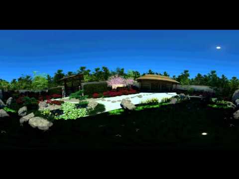

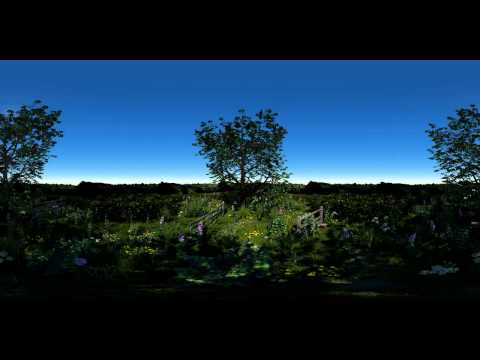

    here are my previous efforts, the one I uploaded then redownloaded and encoded but was only small not superHD

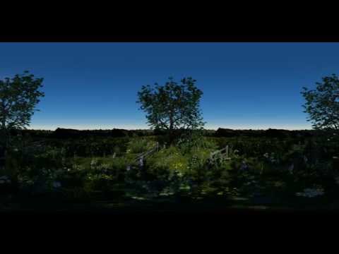

    is the video I am trying to do
    if youtube does not resize it I may be able to download it and add metadata like before but the buggers tend to,
    made it CC dunno if that helps, they often add a download option if you do
