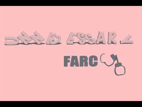

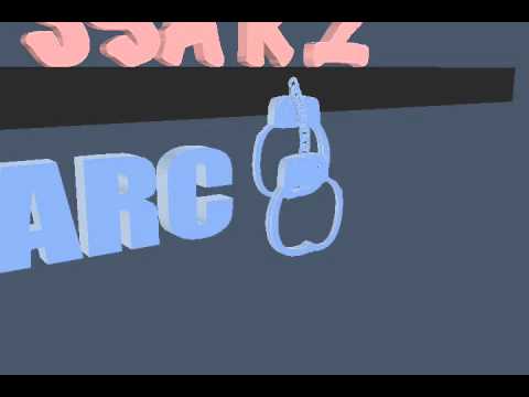

    I animated the handcuffs from the Object browser, which was a group of independent objects. It was built at a weird angle, so I had a little prep work to do before I could rig it, but it worked.
