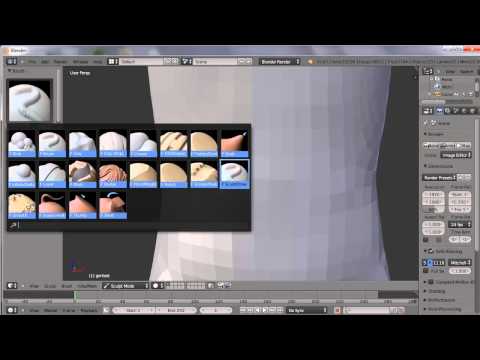

But I followed the tut step by step again, like I did the first time, this is the tut by the way,
and it worked this time. I was able to import the Morph! So I'm wondering if I somewhow missed a setting while exporting or importing to Blender.
