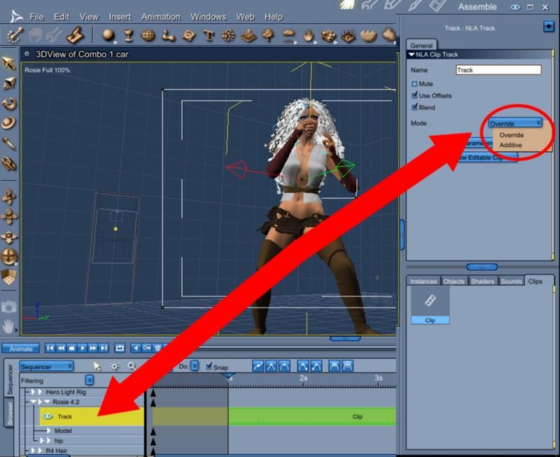

    It sounds to me like the Track modes are set to "Additive" instead of "Override".

    800 x 653 - 343K
