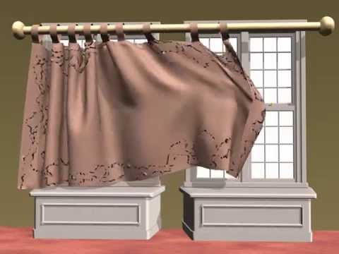

    I must also carry out a curtain for my film in progress, I did much test today in Carrara but it's very difficult.
    Here a “quick” test with the Marvelous Designer-Carrara association , it is easier.
    There are meshes exploded a little in the curtain, it' s certainly because of basic size in MD, I will work on that issue.
    If you are interested, I can easily provide the .car file.
  • Dudu, that's brilliant!
    Dudu, I've seen talk of Marvelous Designer elsewhere, and seen that it lists curtains among its abilities. I've also seen that it has a 15 day trial, although I don't know how complete that is (I don't have the cash for the full thing anyhow). Thank you, but I'll decline your offer of the .car file since this will almost certainly wind up in something commercial down the line (in some form or another).
    Roygee, that video looks interesting, and I think it will definitely help, particularly with the settings - relating numbers to Blender's cloth presets (cotton / silk / canvas etc) will be a real boon.
    Marcus, I think I see that each pin needs to be attached to a separate object, and those objects moved in concert to achieve the "swish". On that basis, my rings sim might work better if the curtain is pinned to each ring instead of just relying on the physics. The way Blender does it does seem rather elegant though, so that's a possibility if I just went with open/closed morphs. I'd prefer to do it all in Carrara though.
