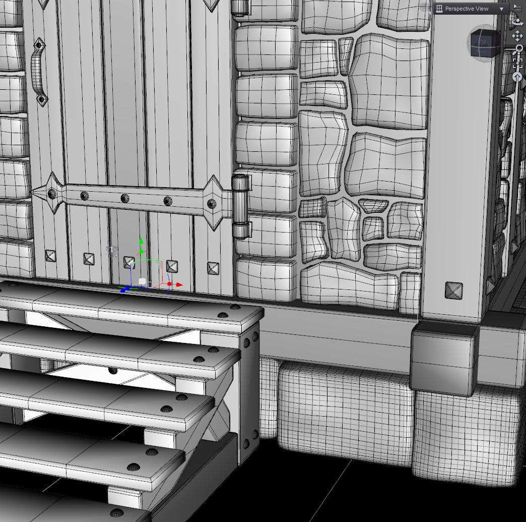

  • Richard HaseltineRichard Haseltine Posts: 109,052
    Some parts do have SubD, though mostly only two levels. If you put the Viewport in a Drawstyle that shows the emsh lines (e.g. Wire Shaded) The the elements with SubD will have thin lines (the vrtual polygons) between thick (the actual edges in the mesh).
  • I tried - but it does not appear to have subdivisions? See image.
    edited 9:27PM
    I can see there are many polys though - is there a reason to use mutliple polys on a single flat surface for example?
    That part doesn't have any faint edge lines, so isn't SubDed. Here only the foundation stones apear to have SubD, which is MVCK 2.5m Large Stone 5-Block Set (Front)
    There are other foundation stone nodes around the building, though, and there may be other elements not visible here with SubD applied
