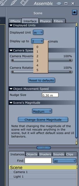

At this point I need to resize a part for a press fit, so I need to resize the part down by 0.004" , but there are only 2 decimal points (0.00)  showing in the resizing area.
Where can I increase the accuracy down to 0.000"  ..... I have looked, but can't find.

    The setting is in the 'Interface' tab of the Scene.

    Thank You !
    That was a great help. :)
