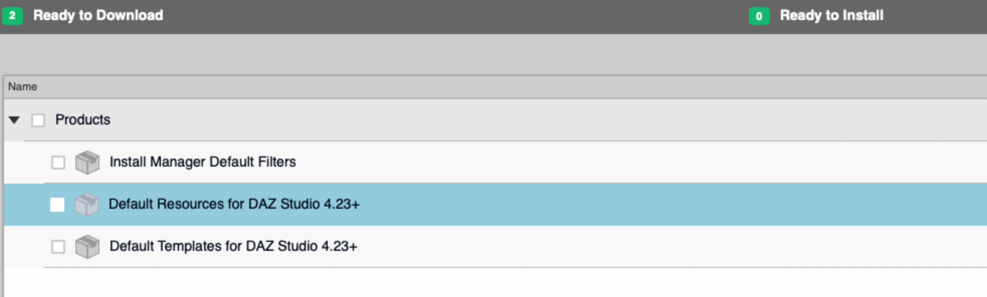

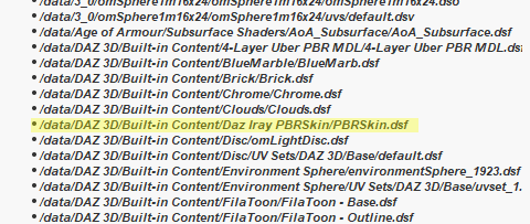

  • felisfelis Posts: 6,154
    If you in DIM for Default Ressources 'Show installed files', does it then include the PBRSkin shader, and at what path?
  • FauvistFauvist Posts: 2,290
    Yes, in the DIM INSTALLED files there are PBR files. I attach some of them.
    1218 x 938 - 318K
    1368 x 242 - 89K
    edited January 28
    This is what it should look like.
    Yours are textures.

  • nemesis10nemesis10 Posts: 3,908
    edited February 1
    To quote Sulu from Star Trek, "Oh, My!"  So you need to have the Default Resources so that is why those materials show up with question marks and the skin doesn't load with the pbr skin shader. Now we have an easy thing to try.
    1. Go to DIM
    2. Search for Default Resources,
    3. Deinstall it if it shows up in the DIM Installed tab (DIm opens with a window with three tabs)
    4. Install it from DIM install tab
    5. Restart your Daz Studio which hopefully now has the pbr skin shader
    1964 x 592 - 237K
    Post edited by nemesis10 on
    I've already done that 3 times.  What DIM sends me isn't the right Deafault Resources.  I'll try it again.
