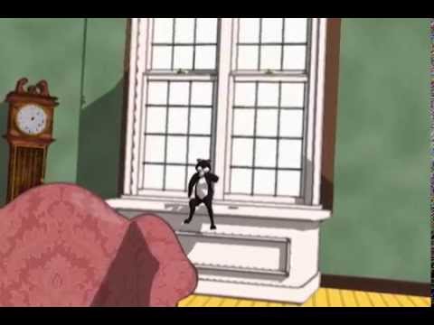

    I've animated with the Generation 3 figures, the Generation 4 figures and dabbled with the Genesis figures. They each have their advantages and foibles. I like the joints better in the Genesis figures, but I haven't done much with them, so I'm maybe not the best person to answer this.
    Here are a couple videos using Generation 3 and Generation 4 figures:

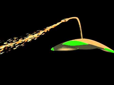

    Particles can do some cool things. They can work really well for smoke, or something like a rocket engine, but for a campfire or something like that, maybe not so good. Although, if you use the particle emitter in conjunction with other effects, the effect can be pretty nice.
    Here are some videos that use particles. The campfire video uses the fire primitive and some shader functions to make the logs look as if there are burning coals. I used a particle emitter for the sparks. I hadn't got around to using one for the smoke yet. I also used animated lights to get the flickering light, which was automated by using a noise tweener between the start keyframe and the end keyframe.
    The Martian War machine was built and rigged in Carrara and has a simple emitter parented to the "head."

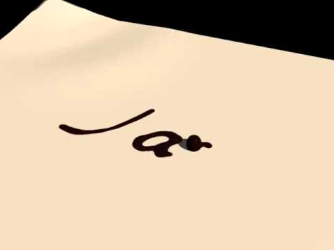

    The emitter can even be used to write. This is a proof of concept loosely based on a long lost tutorial I read once.
