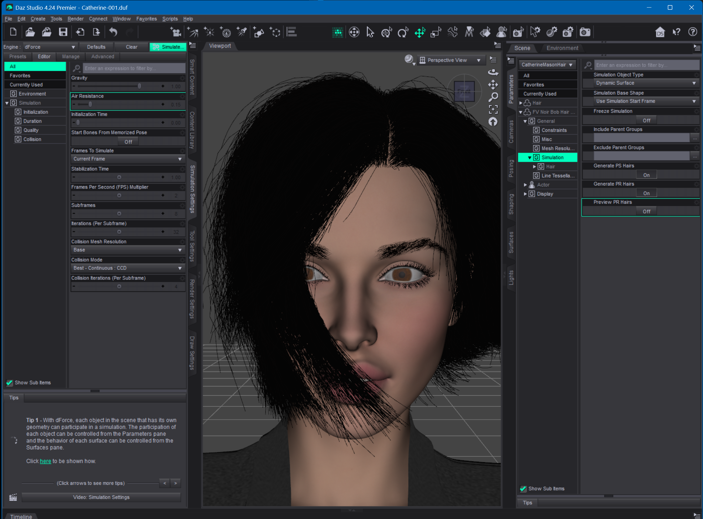

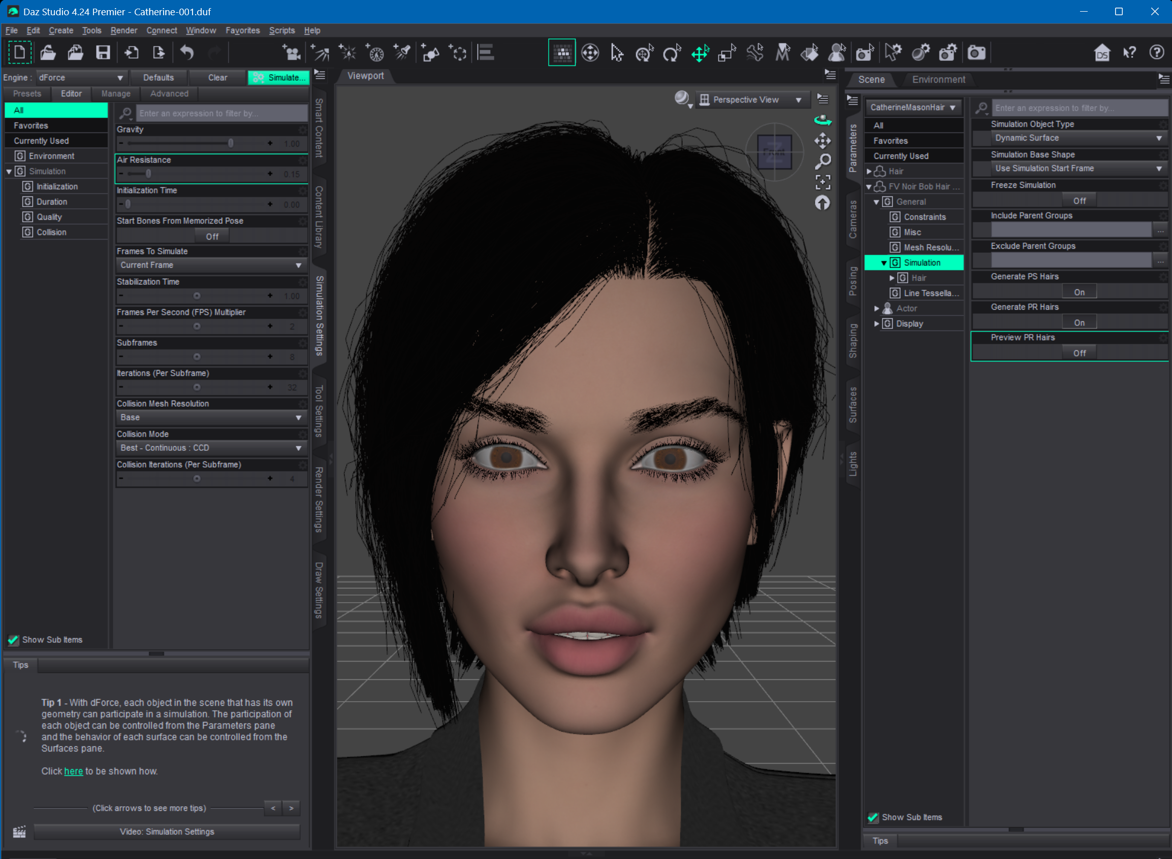

Not sure what I'm doign wrong. I'm trying to run a simulation with "dForce FV Noir Bob Hair for Genesis 9" - there's no wind node in the scene, and I'm running the simulation on a single frame, so no motion. But the hair is swinging to the side as if its being blown. I don't know what I'm doing wrong (or, is that normal)? I just would like the hair to "settle" naturally...
Pre simulation:
After the simulation:
What am I doing wrong? Am I misunderstanding something?

    In the surface settings, try lowering the collision offset. This can cause strange movements when it is too high.

    I couldn't reproduce the issue on my side with the same settings ~~
    It seems there's another Hair on your character's head or somewhere, is that correct ?

    Playing with this and Collision Dampning eventually worked, thanks!
    One of them is the hair cap, the other the hairs. Its still just one, I had the cap selected so you see both.
