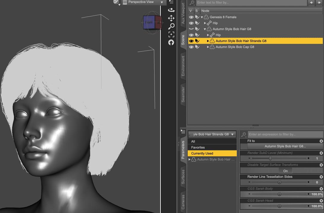

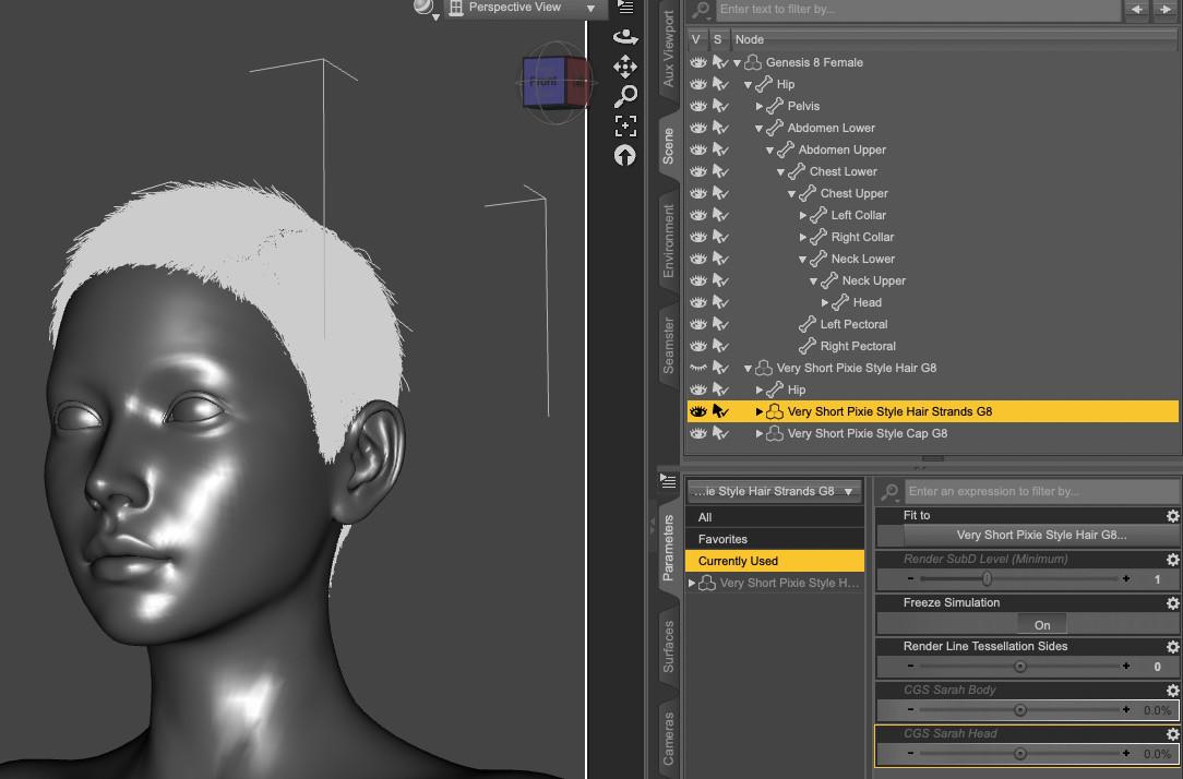

    I have the same problem with Genesis 8 with character who are shorter than Genesis 8, some who are using scaling as part of the shortening process, other, like the first one I tested, who simply have a morph of a character smaller than Genesis 8, and I don't understand why: 'Very Short Pixie Style Hair Strands G8' doesn't fit as it should while 'Very Short Pixie Style Cap G8' fit perfectly
    Here an example with Sarah by CGSerpent (which was free a couple of months ago), sold on Renderhub (no link because they are NSFW user renders on it visible by default):
    Removing the auto-generated morph on 'Very Short Pixie Style Hair Strands G8' seems to solve the problem:
    I tested with other characters, including Daz Originals like Victoria 8.1 or characters sold here to remove the possibility that CGSperpent did something wrong while creating the CGS Sarah Head and CGS Sarah Body dials, and the problem does happen with pretty much all of them to some extend.
    The same problem doesn't seem to happen to another strand based hair by Out of touch:
    Does someone know how to solve it ?

    Something I didn't initially see: if you're applying the 'fix' I'm speaking about (dialing down to 0 the body and head morphs for 'Very Short Pixie Style Hair Strands G8'), it's possible your scene files will be much bigger than they should and as a consequence, much slower to save: I saw the problem today while opening a ticket to report the problem and a scene with a Genesis 8.1 dev figure wearing only the hair (with nothing else in the scene) was ~10 times bigger when saved with the 'fix' applied.
  • crosswindcrosswind Posts: 9,739
    Correct. That's the default behavior in DS... If you do the same thing on other conformers, e.g. garments, geo-grafts, the "zeroed deltas" will be saved within the scene file.
    So in such a case, you can uncheck Auto Follow in Parameter Settings of Body / Head morphs on the hair strand... or directly delete Body / Head properties in Paramters pane before saving the scene file, then the file size won't be changed.
  • ElorElor Posts: 3,590
    I didn't know that so thank you: it'll fix the size problem while waiting for a fix of the overall problem.
