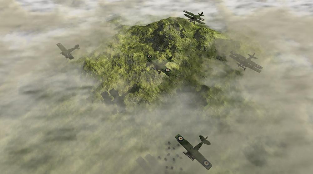

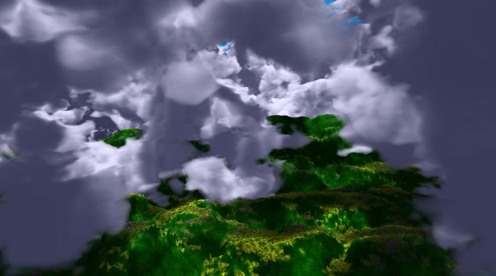

    I have some questions... is the HDRI output of Bryce capable of providing proper/good IBL in, say, Daz? That's been a bugaboo of mine for a while -- I've tried all sorts of methods to make HDRIs with decent lighting qualities, and they've all either failed outright or been substandard.
    Also, can you create a render/sky with clouds below you? I've wanted to do that effect for a while and Carrara has proven uncooperative.
  • FishtalesFishtales Posts: 6,224
    edited October 2015
    This one I did a while ago Will. Clouds, mist and airplanes smiley

    Or this one.
    Click on image for full size.
    1000 x 556 - 273K
    1000 x 556 - 253K
