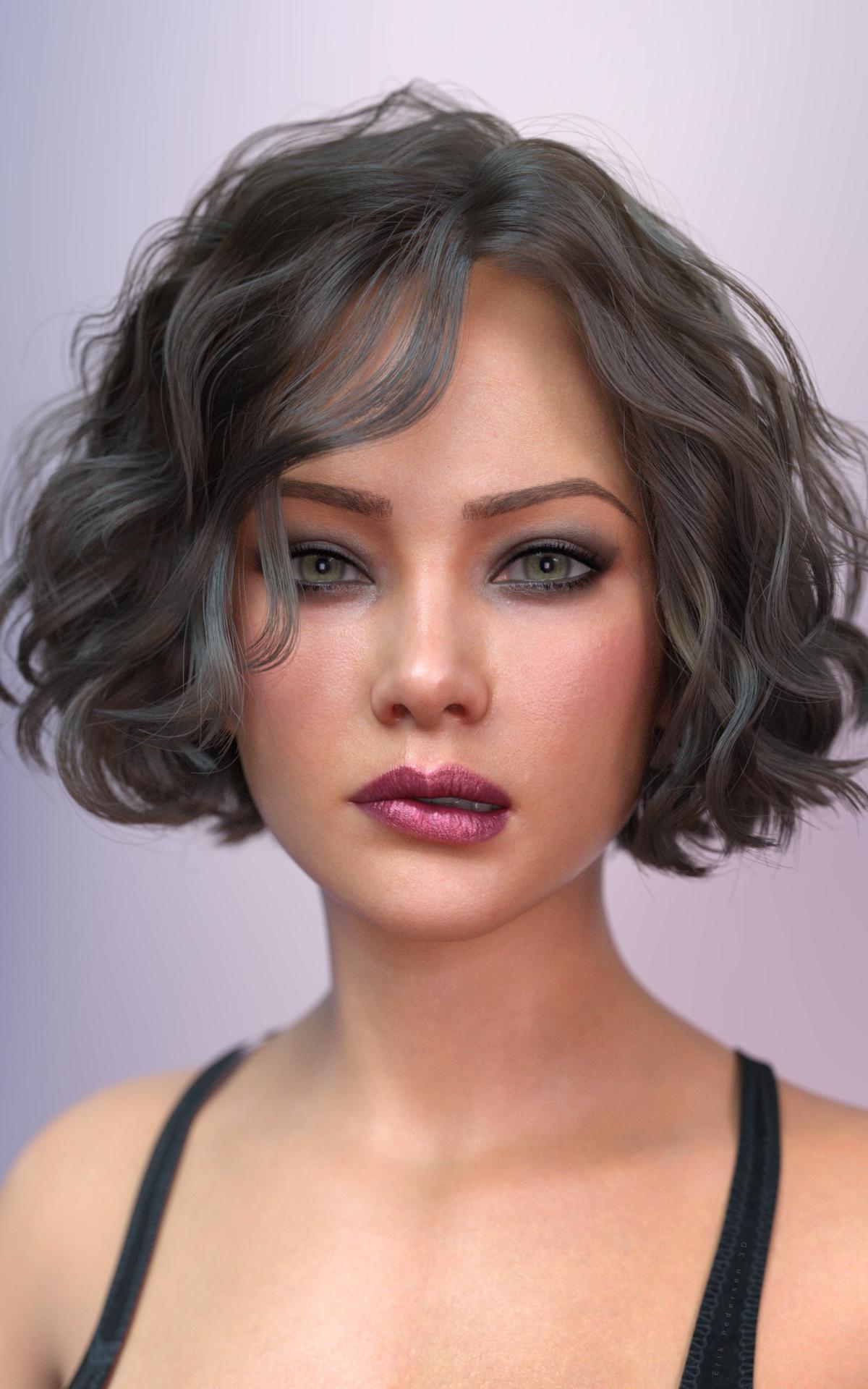

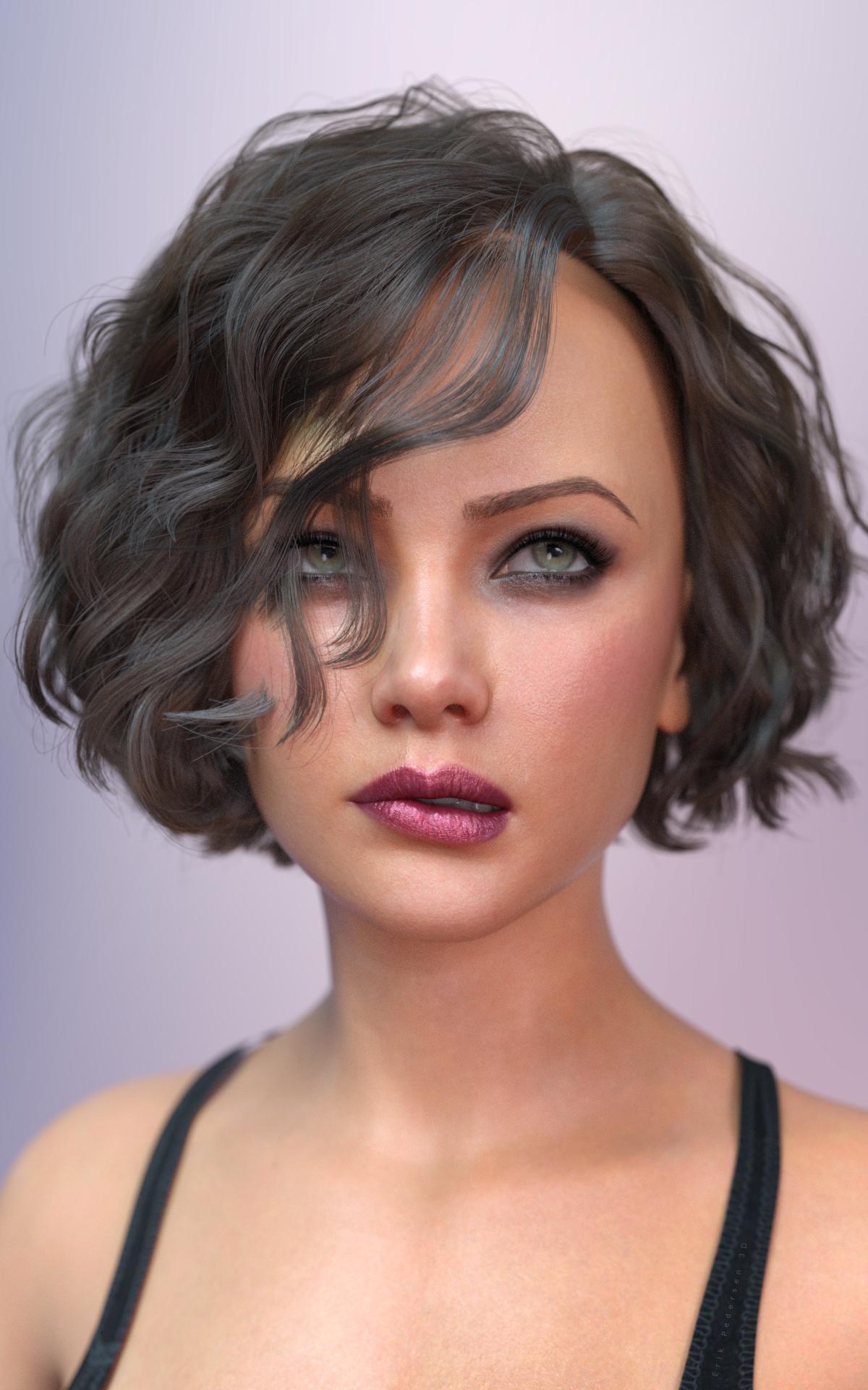

  • GoggerGogger Posts: 2,507
    edited September 2025
    I just tried to use this hair and was was thinking "This is some B()ll$#!t!" (- Harry, from Resident Alien) but at least was able to use XYZ rotators and get something useful.  I will be glad when they release an update for it, I can see myself using this hair quite a bit.
    Diana is wondering if it is worth the hassle - yes, Diana, very much so.
    Manually adjusted:
    This is how it loads in on Diana by Exart G9F - no tweaks:
    1200 x 1920 - 1M
    1200 x 1920 - 1M
