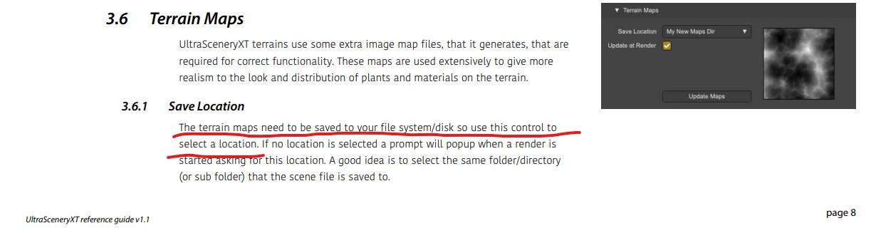

    I may have found the problem, maybe Daveso can confirm if this works for him too. You need to save the Terrain map before rendering, at which point it will create a Flow map that I assume determines where the biomes go. It was allowing me to continue and render without saving the terrain map first, which is why I thought there was something wrong. I don't know if it was always this way or if the save location matters (I saved it in an existing UltraSceneryXT folder), but so far, three tests have worked. I'll try to find the manual and see if it mentions this, wish me luck in finding it.   ;)

    From the manual:
    3.6 Terrain Maps UltraSceneryXT terrains use some extra image map files, that it generates, that are required for correct functionality. These maps are used extensively to give more realism to the look and distribution of plants and materials on the terrain.
    3.6.1 Save Location The terrain maps need to be saved to your file system/disk so use this control to select a location. If no location is selected a prompt will popup when a render is started asking for this location. A good idea is to select the same folder/directory (or sub folder) that the scene file is saved to.
