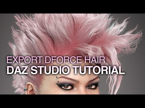

  • Just found this, not specifically about 'capped tubes' but it does at least show how to get Strand-Based hair into Bender.  You basically just have to ensure that 'Tessellation Sides' is set to at least 3 so that it turns every strand into tube form.  Then export it as an standard object, and finally import it into Blender.
