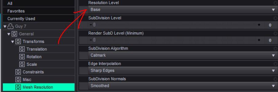

    It shouldn't make a difference as far as the version of Daz Studio - most of the DS versions released in the past few years have the same Morph Loader Pro, it's not changed IIRC. However, the issue you're having sounds like it is likely due to you not exploring the figure as an OBJ at it's BASE resolution. By default the figure loads with a sub-division level. You'll need to go to the Parameters Tab and change the Mesh Resolution to "Base" before exporting:
    Also make sure you're exploring just the figure and not any attachments (delete any eyes, mouth, etc, that may be attached to the figure first).

    I thought I mentioned, but evidently forgot, that I did export at BASE resolution. It's 60560 polygons.
    And unfortunately I can't just export the figure (ie: skin) because the morph also affects the eyes, mouth, lashes, and brows. I tried exporting and importing the parts separately but that didn't work either.

    Well, if so, to clarify some key points:
    1.  Write Separate Objects option means when importing OBJ file in other applications, OBJ can be splitted into separate objects. If uncheck the option, OBJ file can be just imported as a single object. However, it has nothing to do with including the sub parts into OBJ file or not...
    2.  If just want to export G9 figure per se without including the sub parts, you need to select G9 first, check the option Filter Objects in Export Options dialogue, choose Primary Root (or Selected Roots...) Then it'll only export G9 root node only
    3.  Yes, if you you ever Updated and Merged Menus in DS 4.23+, the menu structures under Edit would be changed a lot ... You just use Morph Load Pro no matter when its menu item locates...
    As for geometry mismatch issue, make sure you firstly set Resolution Level to Base on G9 figure, then export to OBJ by using the options described in above 2nd point.
