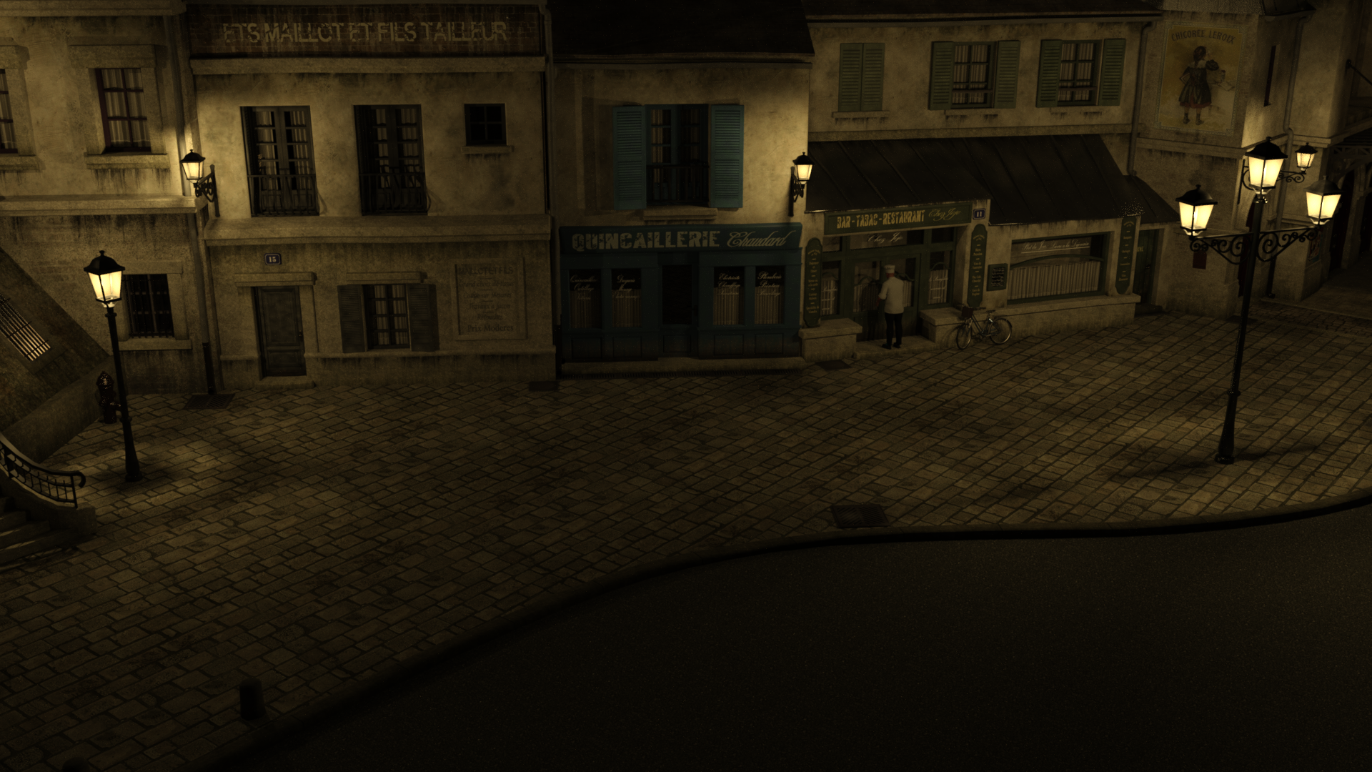

jeffbdvsjeffbdvs Posts: 42
Setup goes well, no problems there. Color and intensity of the emitted light is correct, too. But the color of the emissive surface itself is blown out to white. How do I get the streetlamps in the attached screenshot to appear bright yellow instead of bright white, please?

  • jeffbdvsjeffbdvs Posts: 42
    edited January 2025
    jeffbdvs said:
    That said, I'll try again and see if maybe I missed other Tone Mapping parameters that might help get the look I want. I'll post some screenshots. Thanks!
    Attached. I lowered the Luminance value to one that gave me the bright yellow look that I want from the lamps. When I tone-mapped with that luminance value set, I got the result shown.
    Please let me know if you spot something I've done wrong. Cheers.

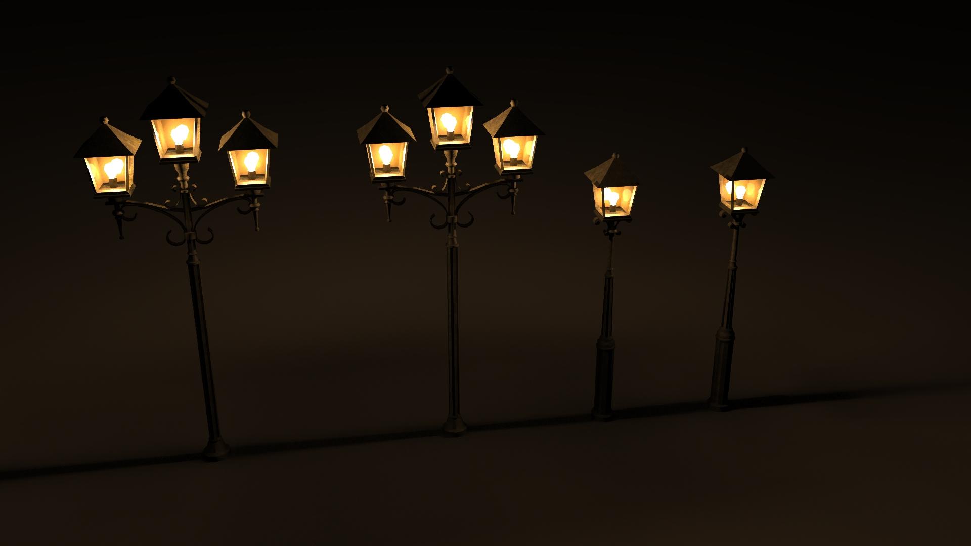

  • FishtalesFishtales Posts: 6,216
    edited January 2025
    I zoomed in and there is a bulb inside unfortunately it is part of the glass. I used the Geometry Tool to select it and made a Region and a Surface for each bulb and made them Emissive then saved them as a Prop.

  • crosswindcrosswind Posts: 9,626
    Me too. I always prefer to using a bulb or a separate geometry if there's any... to emit the light. Or place one there if there's nothing inside.
    Click on image for full size.
    Very, very nice! Top effort.
    I went a different route and left the bulbs alone, instead adding sphere lights of the correct color and temperature inside the fixtures. I like the look of your fixtures, but I like the color and throw of my sphere lights. What do you think? It's called "The Day Begins"
    Very nice. It doesn't really matter how you do it as long as it works and you are happy with it.
  • Thank you again for helping me with this. And for taking the extra time to make those new light props. They do look good!
