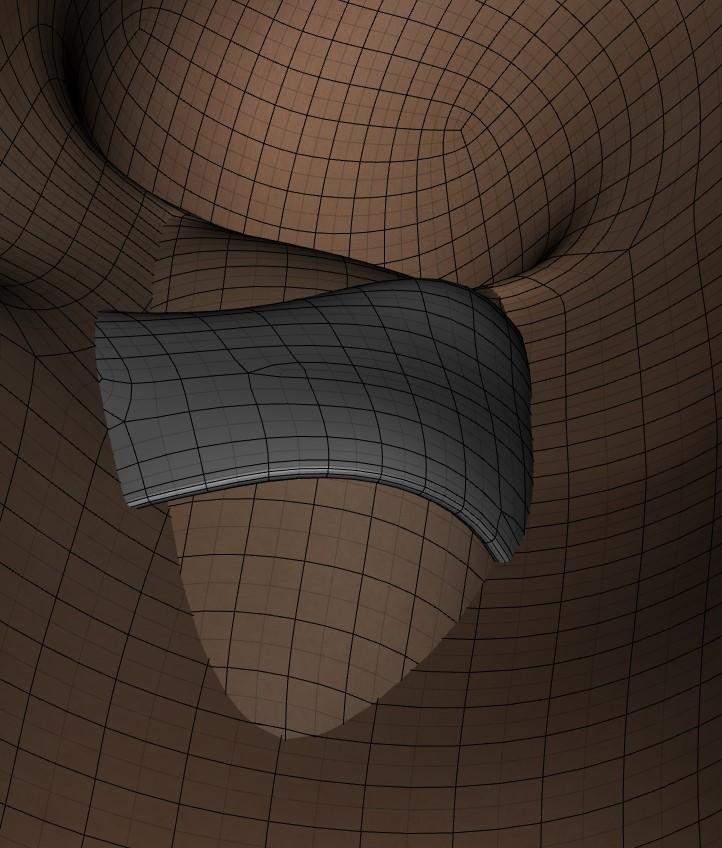

    However, I sometimes fix them in Blender, by using Smooth / Draw / Grab brushes as well as a Mask (with well-set material zones), and fixing from "inner side" is needed, e.g. the below example.

  • MadaMada Posts: 2,044
    I use the move tool in Modo to fix the mesh, grabbing the polygons and moving them into place. If I use the smoothing modifier I will set it to not collide against the figure because it can cause unexpected issues and make it even harder to fix in a modeler (when the mesh is squished between the body and the arm it can really get distorted)  and also with rolled edges/trims pushing through the outside of the cloth because its closer to the figure and pushed a different amount as the mesh further away from the figure.
    If you find it challenging to do the full morph in one go, you can do them incrementally... - bend the arm half way, fix that, import the morph, dial it up and pose the arm to the full bend, then export with the morph active. Delete the halfway morph from the clothing. Fix the morph on the full bend and import :)
    edited November 2024
    Basically you want a sleeve to be outside the arm, and the torso part to be outside and not inside the figure.
    Image 1: View from inside the body (with smoothing turned off) the arm will be inside the body and the sleeve will be outside the arm
    Image 2: Arm bend down, no poke throughs on the torso
    Image 3: Doing it that way will avoid poke throughs when you have the arm forward and bend down - in this image the arm is bend 30 and front back 95
    722 x 848 - 136K
    638 x 961 - 138K
    707 x 601 - 110K
    Post edited by Mada on
  • JamesJames Posts: 1,165
    Ah... so it's okay for the sleeve to go through the torso.
    it's okay for the sleeve geometries around the arm pit to intersect with the cloth geometries around the torso.
    As long it still looks good from the outside.
