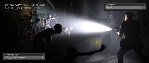

  • DiniDini Posts: 115
    edited June 2015
    When I with Easy Volume render the picture is just black.
    I would like to make such a picture. But how ???
    Can someone please show once the settings so that I understand it?
    Thank you
    edited October 2015
    dqb400 said:
    I am having trouble with the EZ volume camera doing a black out. The camera will ignore any light I tell it to flag for volume (either through the _catergory, the light intesity fields, or by telling it to recognize all light types). If the light is not flagged then the EZ volume camera will recognize illumination but it will ignore all volume calculations. Is anyone else having this problem?
    I am using DAZ 4.8 pro 64 bit
    So, yesterday I again experimented with "Easy Volume" to find out why my Render are always black and have found the solution.
    You must turn off "Progressive Rendering"!
    As I did that, had to see the "light rays" and I could "Easy Volume" use as described by the manufacturer.
    Now it is really fun to work with. It's great that I can assign each spotlight a beam of light now or not!
    (My English is not good. I used the google translator German / English. I hope Goggle has everything translated correctly! * Smile *)
