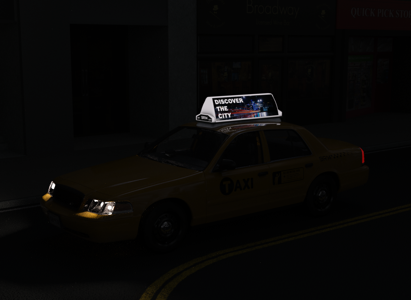

Well flash forward three years(!) and I've got the taxi on my screen. The mesh seems... daunting? I'm having a hard time selecting anything on this model using the Geometry Editor as the surfaces and face groups don't really seem to make very much sense. I suppose I could export to Blender and manually rework the material zones (maybe) before importing again, but then I'd have to re-rig the doors etc etc... would be nice to have a simpler and cleaner solution.

    Well, there's no material zone defined for interior headlights / rearlights and you have no way to select the polygons as well as they're not dense enought... Actually they're shown by using a Normal Map. (ss1)
    So either: you can easily locate the lights on Normal map and create a Mask map accordingly. Set the map into Emission Color slot to lit them. (ss2)
    Or: insert primitive spheres / planes there with Emissions, or spotlights with Light Geometry... yada yada. You don't have to send the car to Blender ~~

    Yay! Thank you! That works for my needs, for sure!
