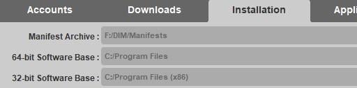

    In Install manager go to Advanced settings ands in the Installation tab check that the paths for 32 bit and 64 bit software are correct - I suspect they are the same and you are installing one over the other.

  • What are you installation paths, the equivalent to those in my screenshot?
    The same as yours, UPDATE: I have got it to load now but every time I go to load a scene in from my saved scenes, DS crashes and says this: "DAZStudio.exe caused UNKNOWN_ERROR in module "C:\WINDOWS\System32\KERNELBASE.dll" at 0033:00000000FD71B699, RaiseException()+105 byte(s)"
