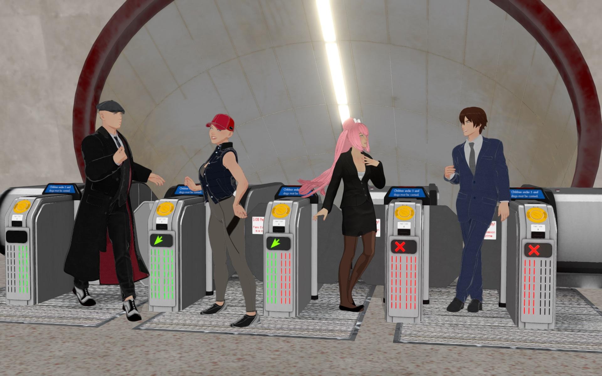

  • barbultbarbult Posts: 26,414
    edited October 2024
    I started with Base Anime Feminine and dialed some Bette converted to G9. The environment is Colorful Toon Street. The hair is Nyoko Hair.from Aiko 3
    2000 x 1500 - 2M
    Post edited by barbult on

  • crosswindcrosswind Posts: 9,653
    barbult said:
    I started with Base Anime Feminine and disled some Bette converted to G9. The environment is Colorful Toon Street. The hair is Nyoko Hair.from Aiko 3
    Pretty !  yes You turned on Bloom ?
    edited October 2024
    crosswind said:
    No, I didn't. This is just the way the Filatoon shader made it. The bulb has emission on.

  • ArtiniArtini Posts: 10,407
    edited October 2024
    Finally I can render so fast multi-figure scenes, this time with elevator from:
    https://www.daz3d.com/modular-transit-terminus
    1920 x 1200 - 479K
    Post edited by Artini on
