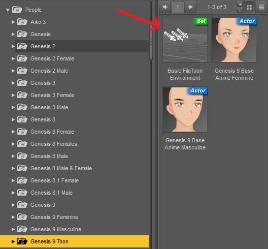

    Thanks a lot for all of your tips, @Dartanbeck
    For quickly set up a FilaToon environment I use a set from Genesis 9 Toon:

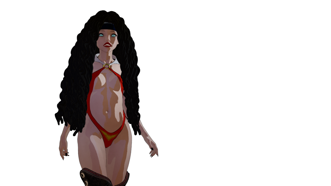

    The way I've been doing it:
    The Distant Light makes the flesh tone. I aim it forward from behind, set the color to the skin tone adjustment I want to maintain, and adjust the strength on a scene per scene basis - though I've got a decent starting point as my defualt.
    Key light (spot) is my main highlight seen coming in from our right on the above Vampirella image. I vary the color for the scene I want. It's usually pretty bright.
    Rim light (spot) is also pretty strong and by default I have mine cascading from over the right shoulder (our left)
    Fill Light comes from near the camera and looks downards slightly onto the character. I use this one to counter the color of the Distant Light to represent the color of the environement I want the scene to be.
    Post edited by Dartanbeck on
    With all of those in my scene, I can rotate them around the character since I have each in their own null which is at 0x, 0y, 0z. And then all of those 'control nulls' are inside the main null so I can rotate the entire rig.
    Why is this cool?
    As seen in the Vampirella example above, I'm casting several tones to define shapes.
    But with a few simple turns of the Y Rotation dials of the light nulls, I can make it flat like a comic book

    Perfect! I hadn't noticed that they've added that! :)

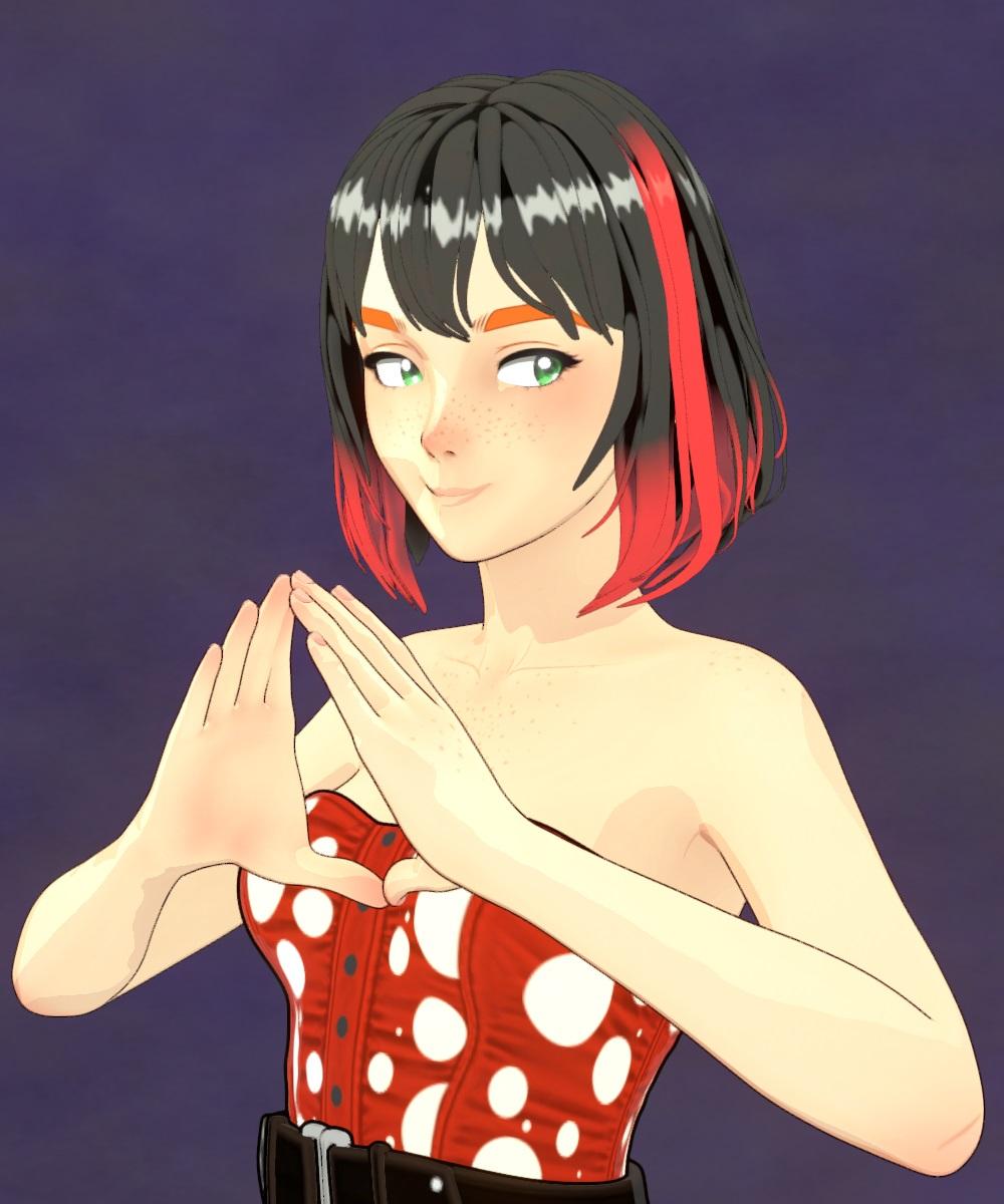

    I really like this texture effect on the hair.
    1000 x 1200 - 192K
    Post edited by Artini on
    Yeah. Me too! I like the whole thing you did here!
    Very cool hair!

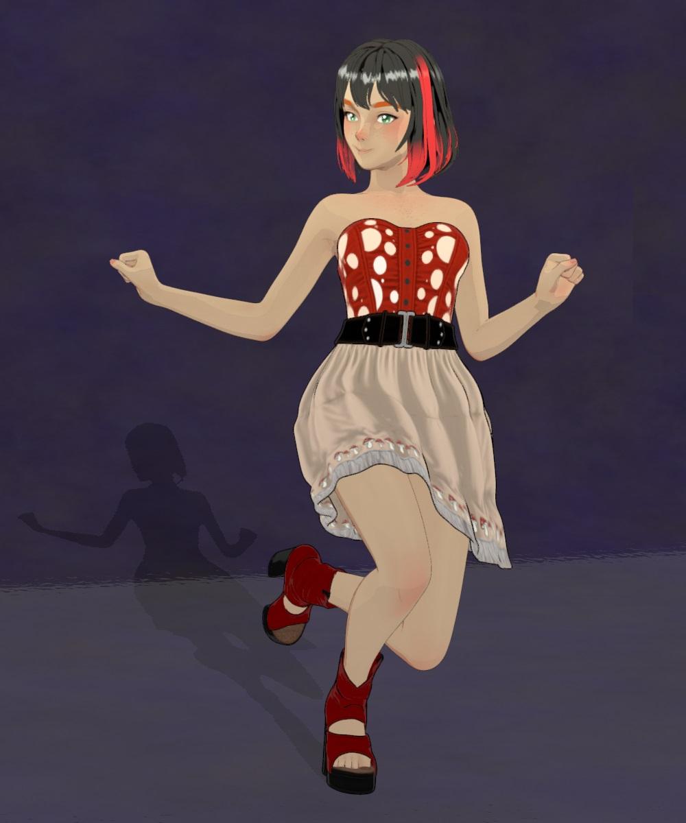

    Thanks a lot, @Dartanbeck
    Using your tips about Deep Shadows enabled, I finally got a render with the shadow.
    Thanks again.
