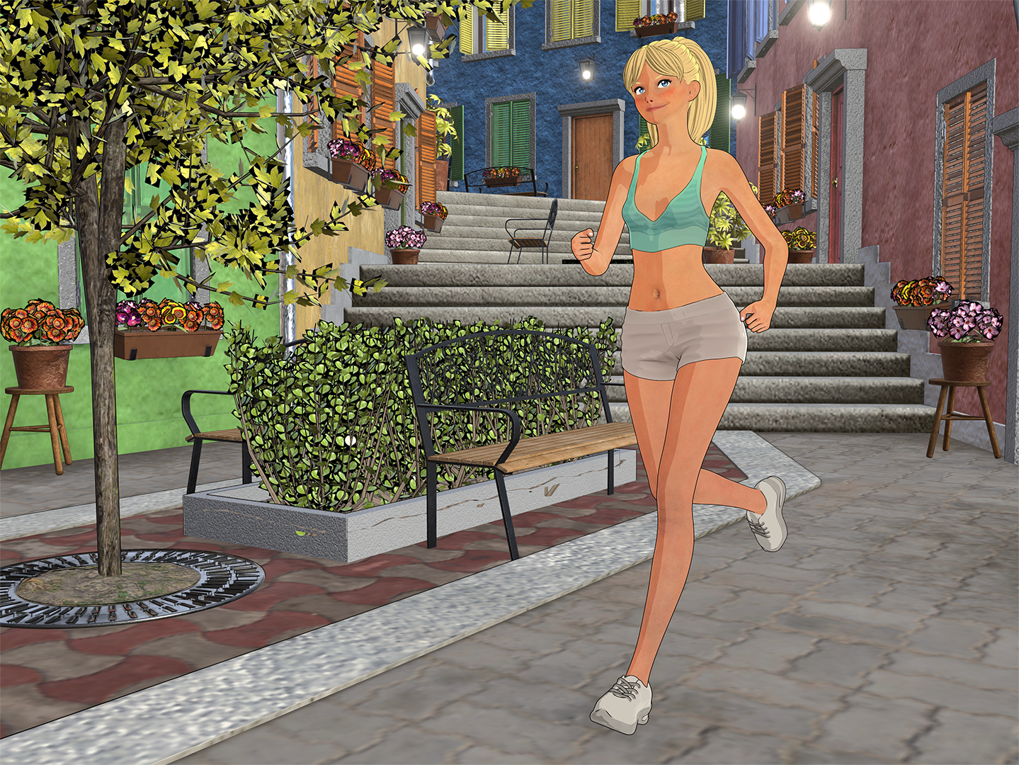

  • Ghosty12Ghosty12 Posts: 2,081
    edited October 2024
    3Diva said:
    rokkr said:
    Ghosty12 said:
    rokkr said:
    Ghosty12 said:
    Just my test of an outdoor scene playing aroound with the night time setting still trying to work it out. Also Genesis 8 using the characters texture, just added Filatoon to it. Did find the setting to make the character shadow more pronounced.
    Cool! How did you make the shadow?
    Thank you. smiley The initial shadow is a distant light, then add in the Filament Draw Options in there you will find three shadow options, Shadow Type, Shadow Map Size and Shadow Cascades. Setting the Shadow Map Size to 2048 or higher and Shadow Cascades to 4 will give a very good looking figure shadow.
    Thank you! I'm still learning to use those "regular" lights (you know, distant, spot, point) since, most of the time, I just use an HDRI with some ghost lights. But I'm making some progress and, thanks to you and other people here, I've learned a lot today!
    Also, make sure on your Light's settings the "Shadow Type" is set to "Deep Shadow Map" or "Raytraced"  - anything but "None".
    Yeah forgot about that bit. laugh The light I used was from Riversoft Arts 3Delight to Iray To Filament converter plugin, so had the shadow was preset to Raytraced.
    Post edited by Ghosty12 on

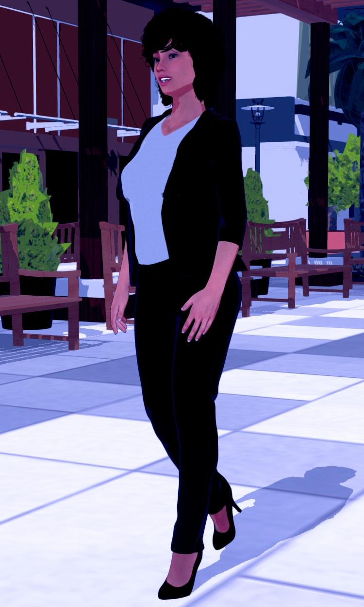

  • cain-xcain-x Posts: 213
    edited October 2024
    This FilaToon shader will be a big boon to those porting over models like MMD or game assets for fan art. It has made those ported models look so much better and removes those ugly seams from the render.
    Still, there are lingering gotchas in Filament to be aware of:
    - Emissives do not light up objects around it (is this a limitation within Filament or has not been fully implemented in DAZ?)
    - Point lights still do not support shadows
    - Cutout Opacity is not two sided
    - Opacity issues still persist due to it being not two sided (likely)
    Post edited by cain-x on

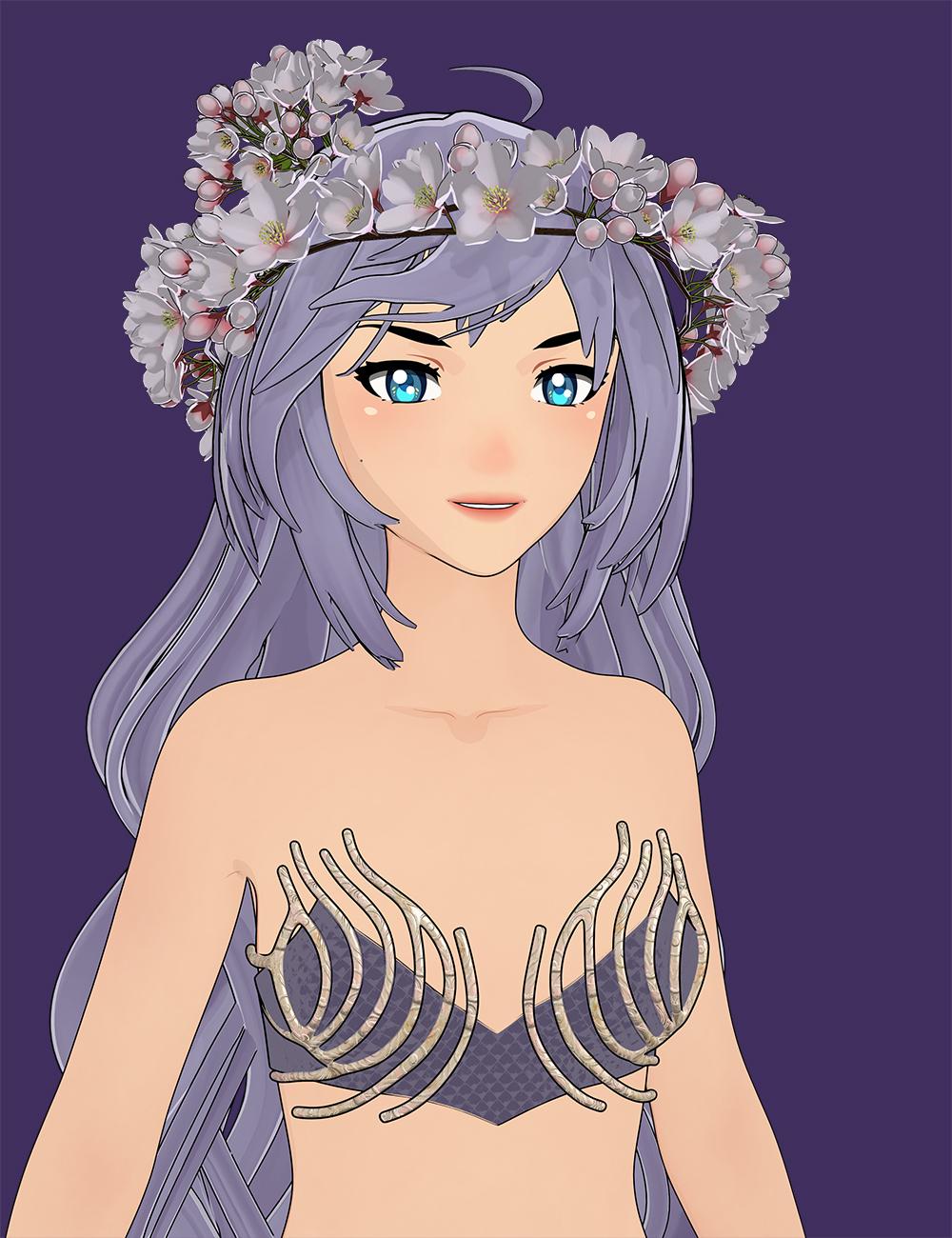

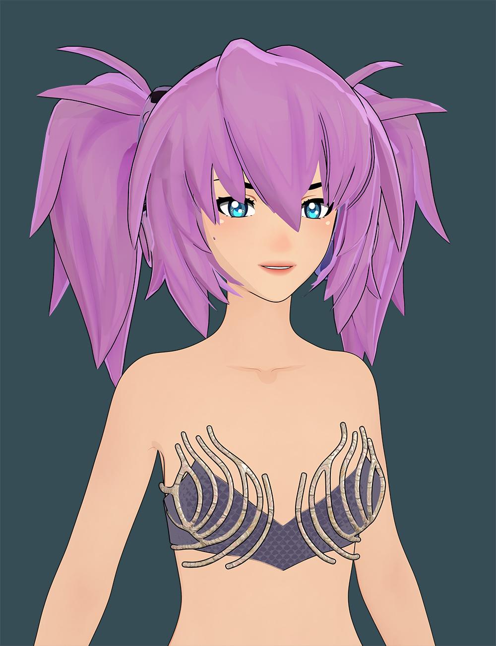

    Okay, so after a few rounds with the shader and a lot of hair ruffling, I got this out of the whole conversion.
    And after a few try-and-error rotations in Ps, I also got something I really like as my new wallpaper.
    All that is left now, are decent environments that use the Filatoon shader proper. Those conversions can get wonky, especially with plants.
    1439 x 1080 - 3M
    1439 x 1080 - 3M
    Post edited by HighElf on
