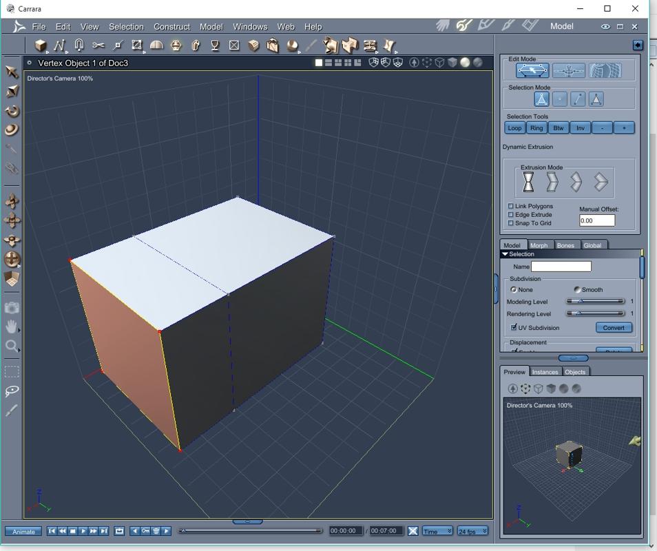

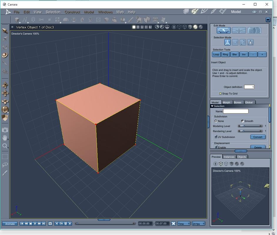

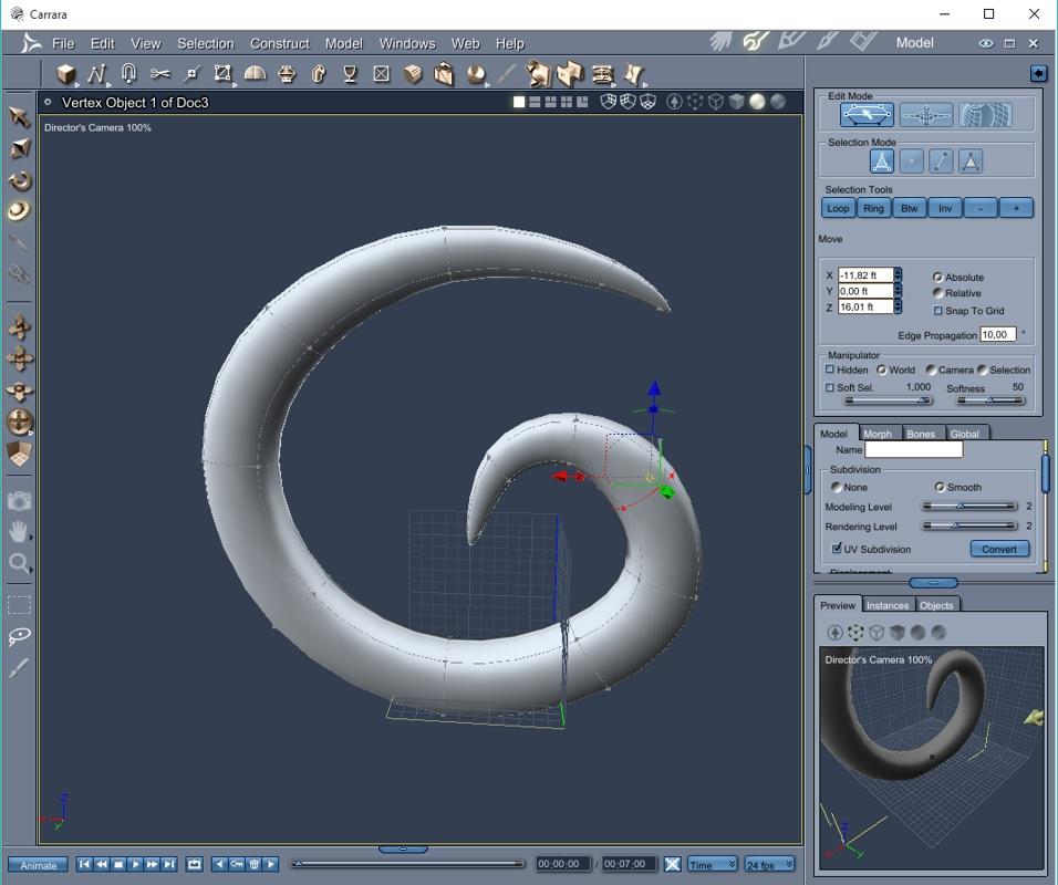

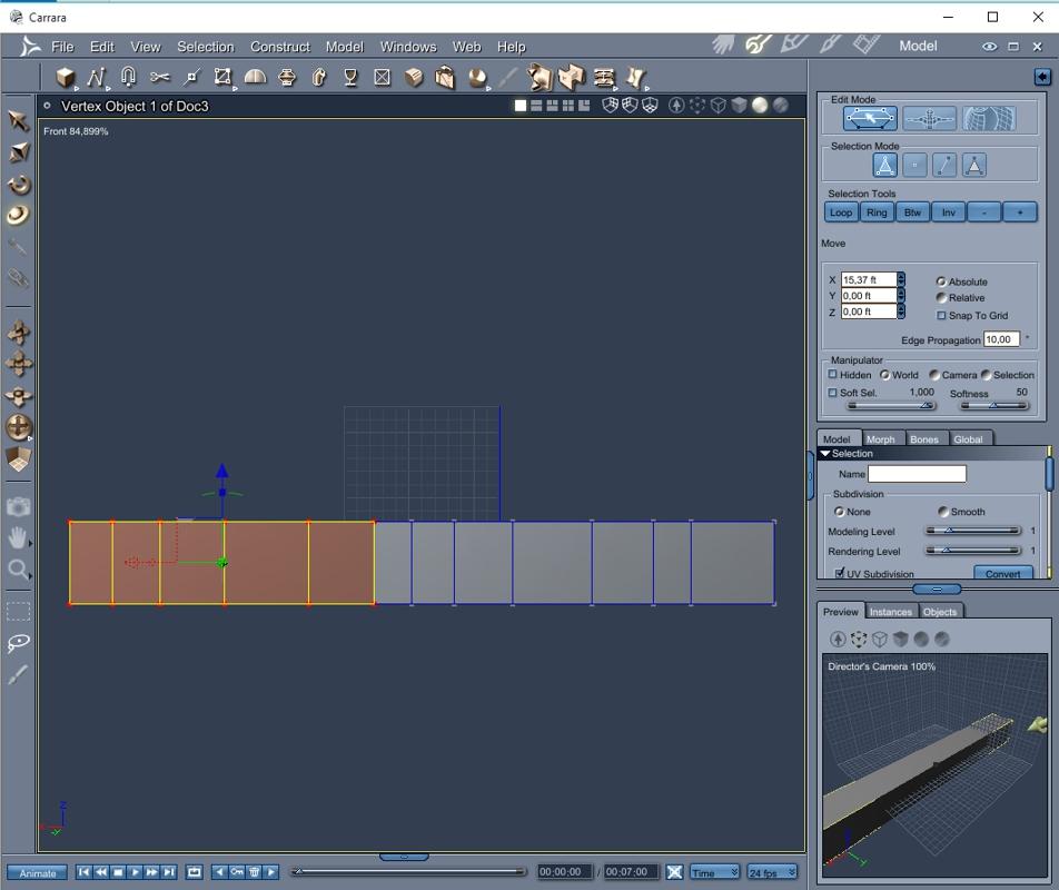

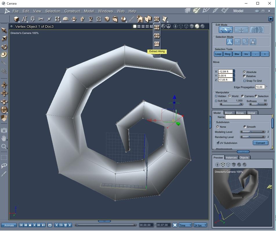

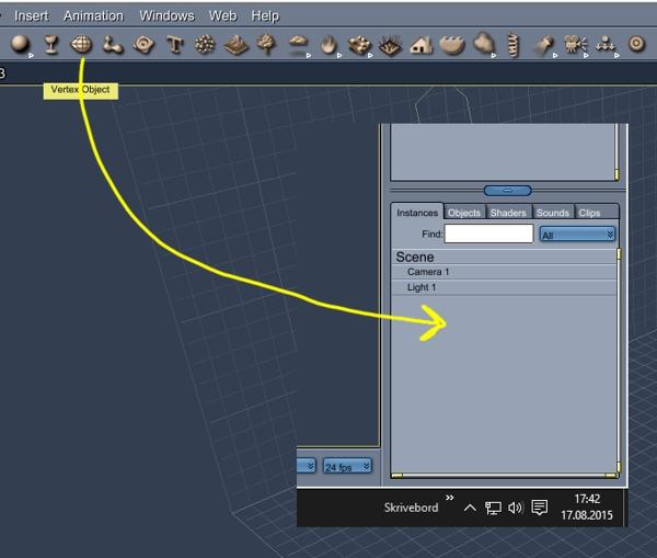

    Insert Vertex object into scene.
    Create a cube. Change object definition to 1
    Using the extrusion tool, select one side of the cube, and start extruding, while holding the Ctrl key at the same time.
    Release the mouse key, and do it again. and again ....
    Until you have enough part to start to work with.

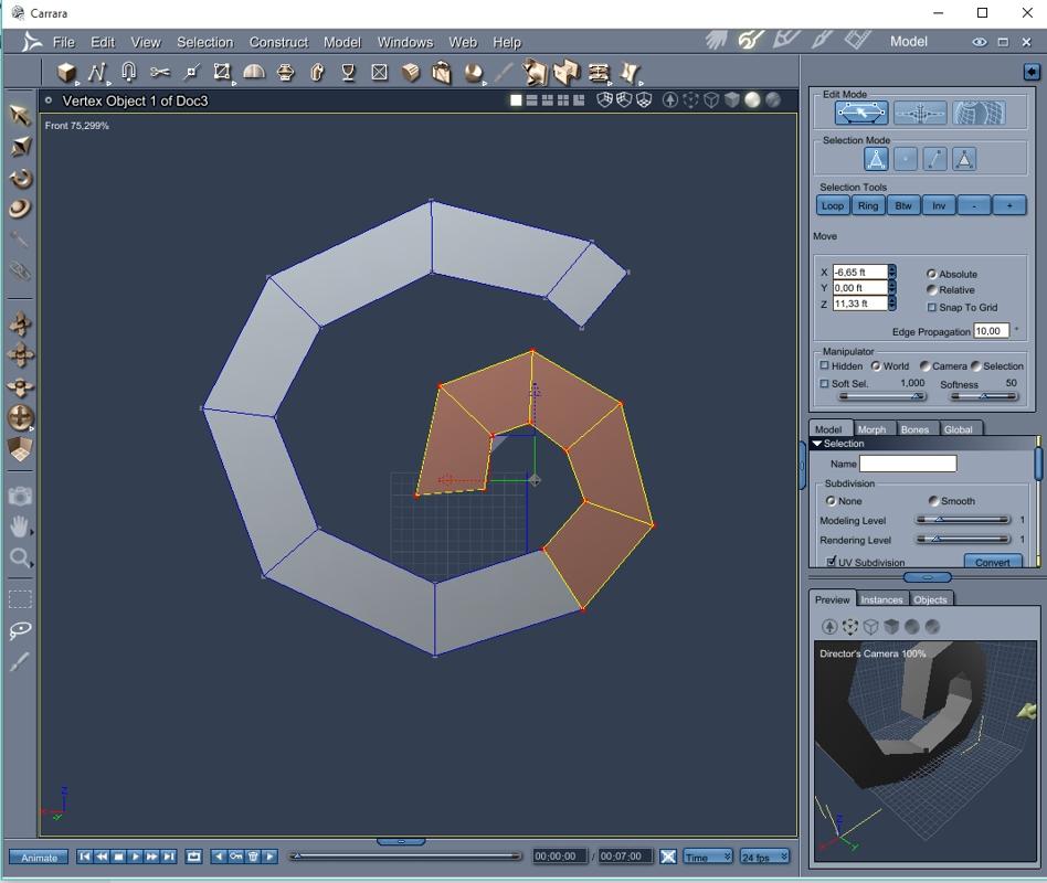

    Switch to front view, and Center the object.
    Use the manipulator tool and start to give the object the base shape.

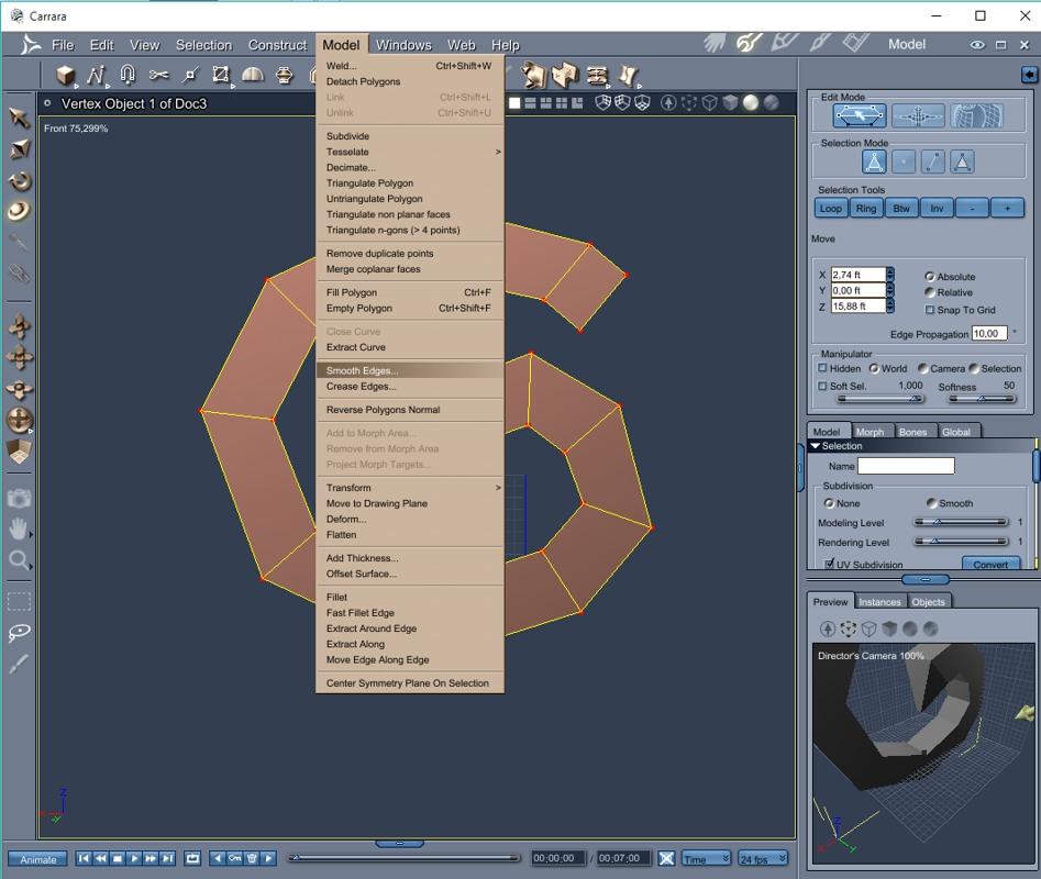

    Select hole object and Smooth All edges.
    Subdivide the object. You van now refine the shape, using the manipulator tool.
    You will probably find that you should have more segments to work with.
    Then set subdivision to None. Select a line, and extrude a new line.
    Subdivide again, and continue to refine shape.

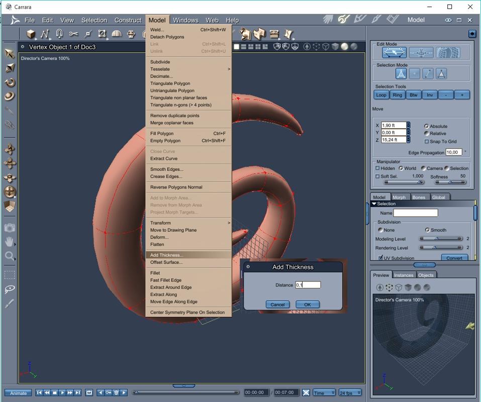

    In the end, since this is hollow glass, select hole object, and Add Thickness. To have thickness on glass, when using refraction in the shader, makes a big difference when rendering, but will add to render time.

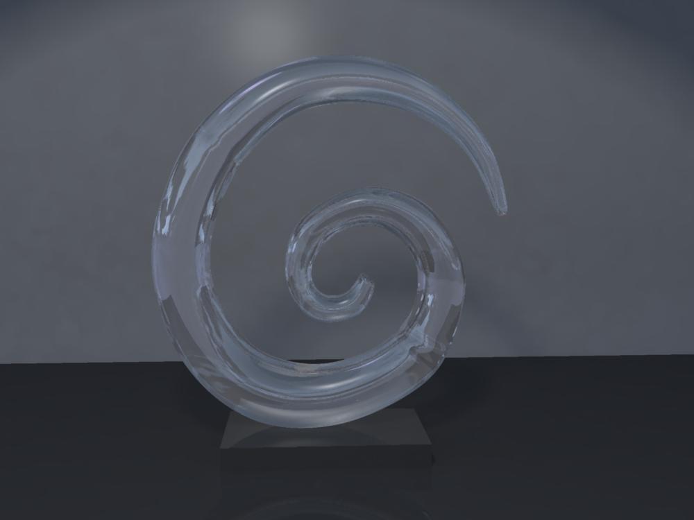

    edited August 2015
    a couple of test renders
    800 x 600 - 65K
    800 x 600 - 42K
