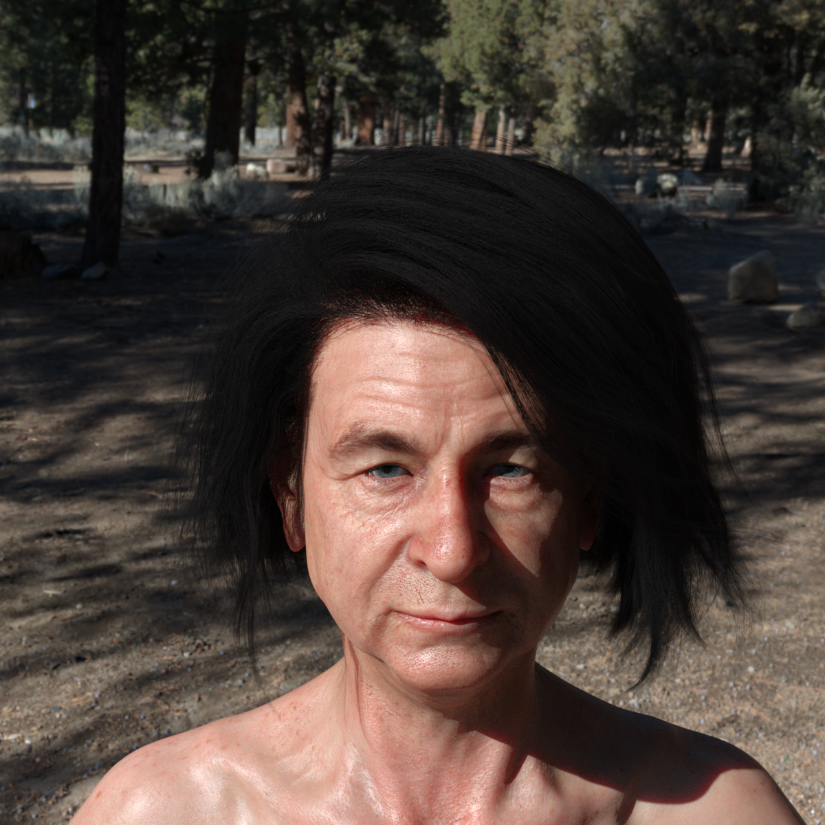

  • felisfelis Posts: 5,915
    edited August 2024
    It is reflections that makes it shinny grey.
    I don't think you in real life can have a hair that doesn't shinne - at least some.
    You can dial up roughness, although I don't know the best way to reduce gloss,
    THis is with a high dye value, as dye apperently gives less shinne.
    1200 x 1200 - 2M
    Post edited by felis on
