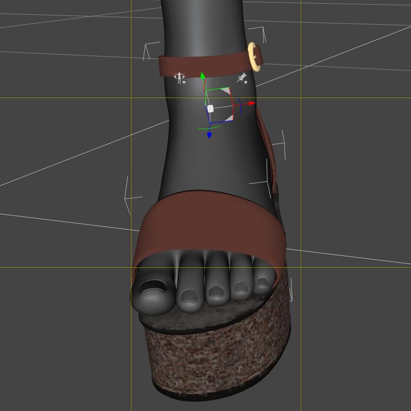

On Genesis 8 or on non supported characters (I didn't see any problem with a test render with Jacqueline 8.1 when I got her bundle with this set of clothes) everything is fine, but if I dialed Victoria 8 or Victoria 8.1 in, all hell break los… the shoes stop following the foot. I don't have any of the other supported characters to test them.
Here's how it look on Genesis 8:
Here's how it look with Victoria 8 or Victoria 8.1 dialed in:
I don't know if I'm doing something wrong. Does someone has an idea ? (I'm already planning on opening a request).

  • felisfelis Posts: 6,149
    I have these sandals.
    And it looks to me as CynderBlue has created a faulty morph. If you look at the sandals, it is a PA generated morph which fails, while all the autogenerated morphs works better.
    How that has happened, I have no idea.
    You can either correct the morph in a modeller, or rename/delete the morph, as it then will be autogenerated, when you dial the body shape.
  • crosswindcrosswind Posts: 9,745
    edited June 2024
    Yes, that's a flawed morph... But have you noticed that the sandal on the right foot is correct if you use Victoria8.1?  I guess that the vendor might've imported the fixed morph with wrong Mirroring setting in MLP... but a final check can usually prevent these sort of faults.... You can just request for a fix.
    But, actually,  you can easily fix it yourself with using Mirroring option as well.
    - Export the sandals, with Resolution Level set as Base, to an OBJ file with the name of FBMVictoria8_1.obj
    - Import OBJ with Morph Loader Pro to update the AutoFollow FBM on the sandals, by using the option of Morph Mirroring, as shown in ss1.
    - With the sandals selected. File - Save As - Support Asset - Save Modified Assets... Done ~
    Unfortunately, with Victoria8 dialed, both sandals are wrong... While waiting for the fix from the vendor, you may fix them with external application, like Blender. It'll be easy as well. A Grab brush will do.

  • ElorElor Posts: 3,611
    Thank you both for your answers smiley
    @Crosswind > No, I didn't see it. I first saw the problem when I fitted them on Tara 2 (which is based on Victoria 8) so I tested if it worked with Victoria 8 then with Victoria 8.1 but almost every tests I did where with the left foot at the center of the screen. I'll follow your advice and will update the morph for Victoria 8.1, will open a ticket and will tried to fix the morph for Victoria 8.
