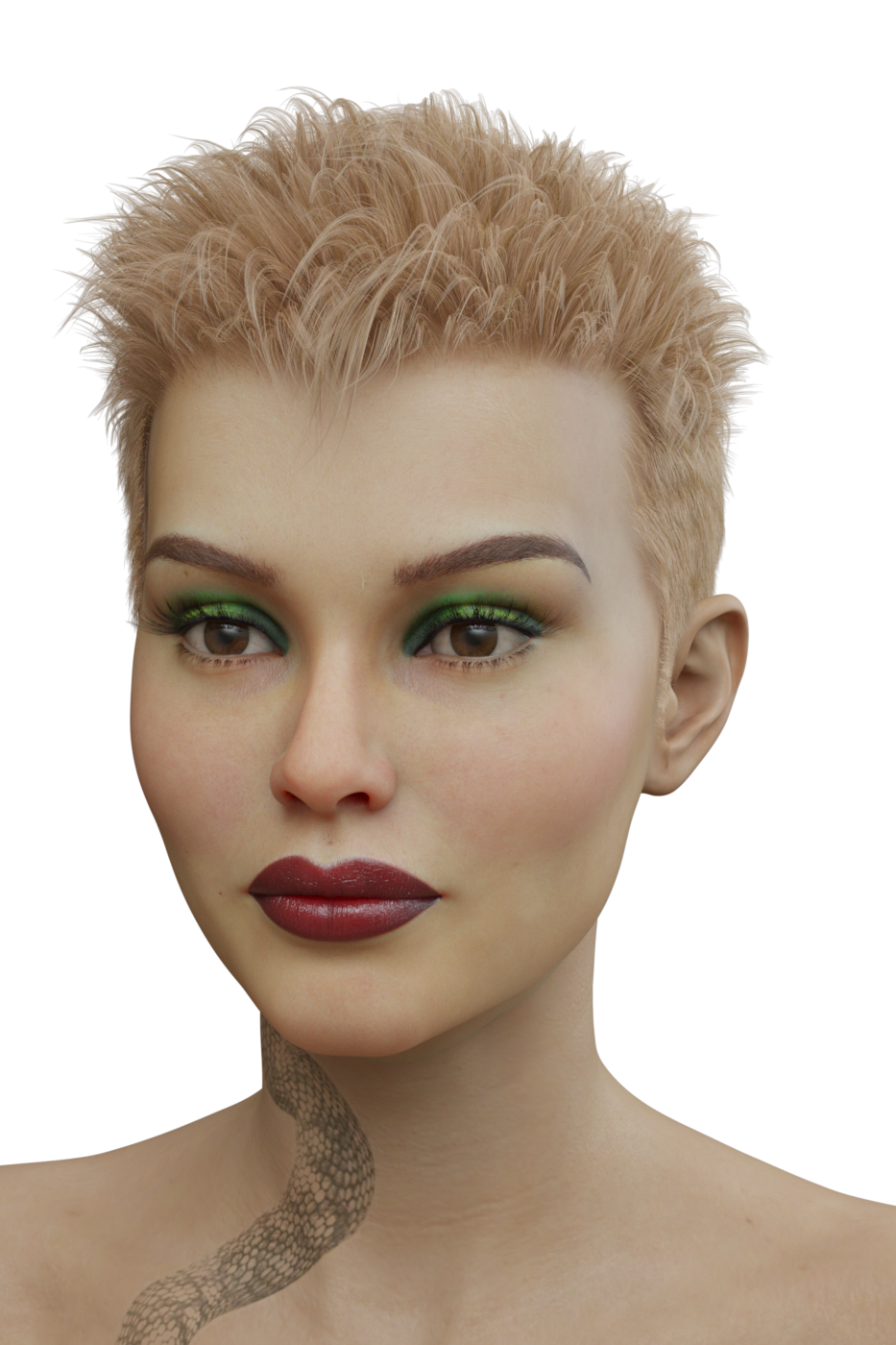

    After loading the hair the setting "Generate PR Hairs" is Off: This is how this looks for a full Iray render:

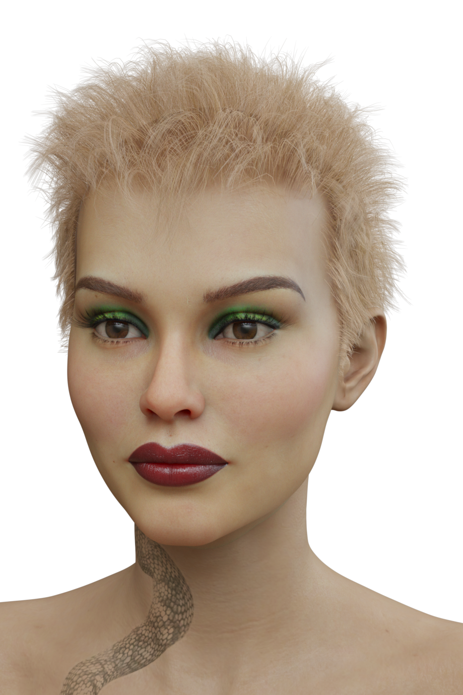

    After switching the setting to On this is my result:

  • DarkRepastDarkRepast Posts: 225
    Weird. The picture I shared was not from the preview port. It was a full render.

  • crosswindcrosswind Posts: 9,623
    I took for granted that everything is well set there... but as markusmatern mentioned, Generate PR Hairs property is off, which should've turned on. You just turn it on, render should be fine.
