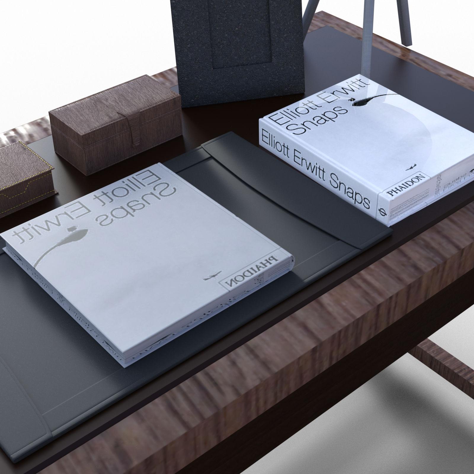

Hello,
Looking at the desk of FE Modern Study, the text are mirrored compared to the same book taken from the shelf sitting behind the desk (it's the book on the right) and I don't know how to change that (without changing the texture file itself)
Another related question, with the same product: I tried to get a picture on the photo stand, so I selected all the polygons from that area, to create a new surface and it didn't work (here I changed the number of vertical and horizontal tiles to 10 I think, to show the problem).
Technically, I solved the problem with the books by using other books (I extracted all props from the desk to get individual versions of them and moved the lamp a bit, to prevent it from falling), but it would be nice to know how to get the correct orientation on them. And I have yet to find a solution for the second problem (I did try placing a primitive plane when the photo is supposed to be, but I failed to get the correct orientation), so if someone has one, I'm all ears smiley

  • richardandtracyrichardandtracy Posts: 7,513
    One way may be to set the "Horizontal Tiles" in the cover material to -1 and then adjust the "Horizontal Offset' to line it up properly.

    I even didn't notice this issue before...
    As Richard said, you just set -1 to Horizontal Tiles on the surface of "desk_Book_B" of the Desk prop, but the book is still "flipped". To flip it... if you own Mesh Grabber, firstly select the "desk_Book_B" surface with Geometry Editor, swith to Mesh Grabber, with Normal orientation, zero Falloff Radius, then rotate and translate the book to the right position.
    If you don't have Mesh Grabber, you also can "cut" the book surface from Desk with Geometry Editor, export / import it as a single book Prop...then rotate and translate it. However, making it with the prop "FE Book_D" will be much easier.
    I didn't know it was possible and doing solve the problem nicely: I played a bit with the offset to get a sligthly better look on the spine of each book, but the geometry is not compatible with the front cover being visible with this trick.
    But your suggestion made me 'remember' the -100% scale trick and it solve the problem at the price of reversing everything on the desk. I said 'remember' because when I loaded the desk preset I created (just two days ago… blush) after extracting all props from the "Desk item" I saw that I did use the -100% X Scale trick on the two books but didn't think of using it on the "Desk item" itself.
    I have Mesh Grabber, but didn't think of using it like you suggested.
    I spent an hour listening to a podcast to extract every prop from the desk to create a preset for each of themblush Well, almost every prop to be honest: I didn't get as far as getting the pen in the three glass holders as independant props but I modified the magnifier to get a lens made of glass, added surfaces here and there. I also did the same with the wall and windows item, to get an independant ceiling and backdrop from the former and an independant painting and window from the latter.

    Hoho ~ I just noticed all the issues you mentioned above, 'cause I just caught a glimpse of the room after I bought and load the product at that time. And you're right, the desk was made with wrongly settings at least on Z Scale. Setting it to -100 is a straight-forward way.
