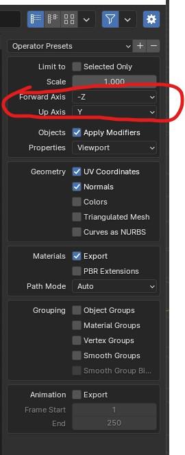

    @edward You shouldn't have to deal with "strange import orientation between daz and blender". Have you configured the Blender export with Daz axis orientation? Forward Axis should be -Z and Up Axis should be Y for exporting OBJ to be used in Daz Studio.
    270 x 663 - 39K
