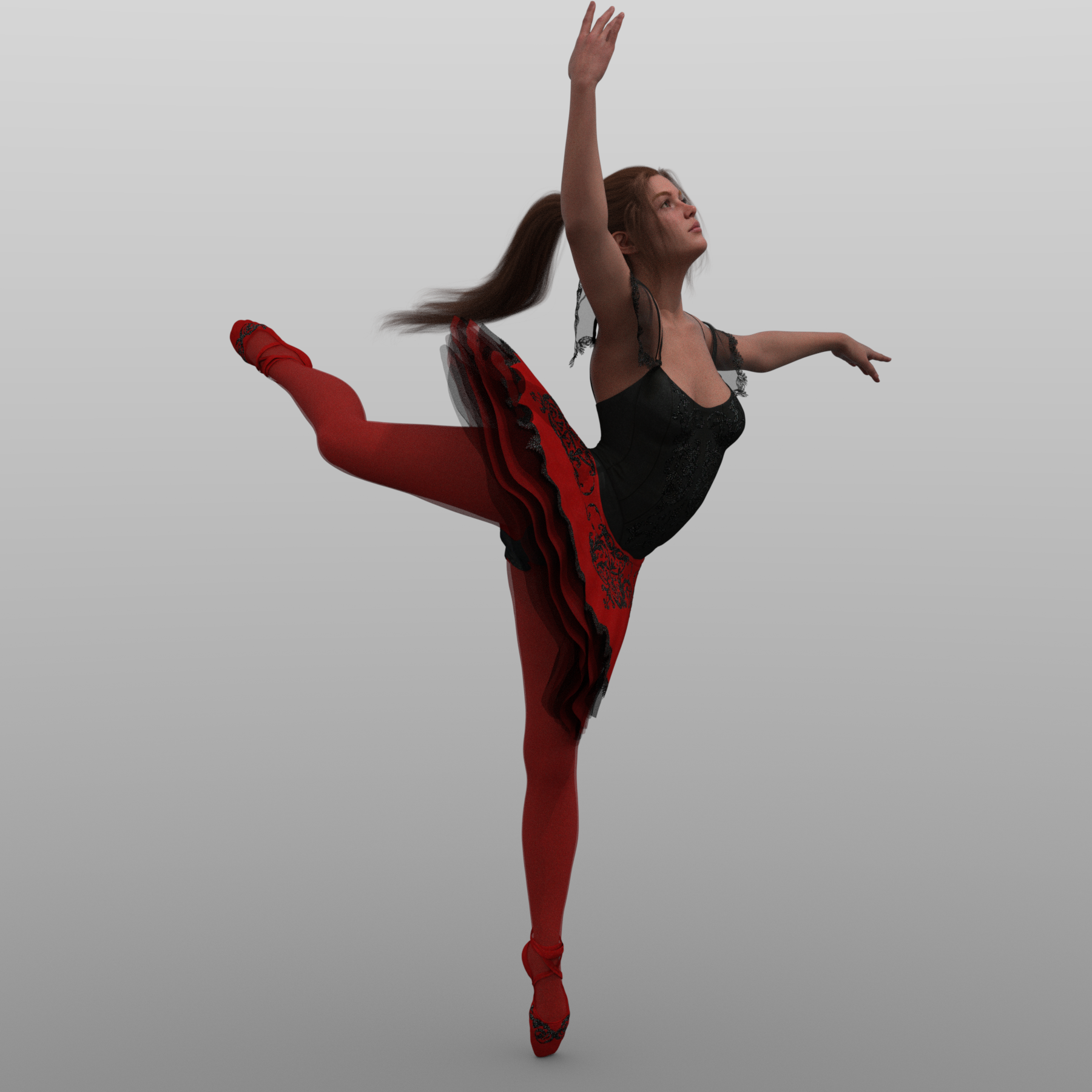

    Victoria 9 in G8 outfit.
    1800 x 1800 - 1M
    Which one are you using? I've tried the Taffeta Tutus and the Ballet Gala outfit so far, and both cause the problems described by the OP.

  • felisfelis Posts: 6,091
    I used this https://www.daz3d.com/dforce-classic-ballet-outfit-for-genesis-8-females
    And as Richard mentioned adjusted the weightmap of the tutu.
