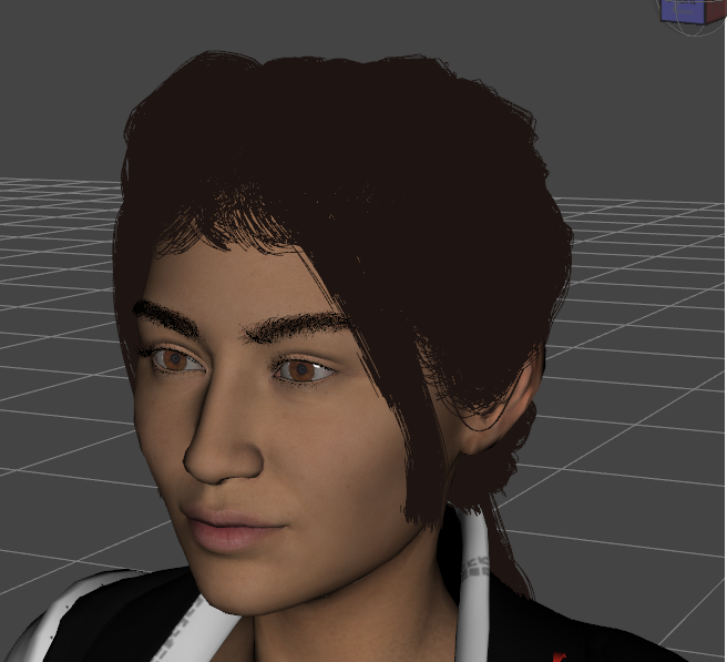

    Let me try again, then. The three main categories of hair:
    Transmapped hair is made out of ribbons that use opacity maps to create the appearance of hair. This was basically the only hair available at first, until the other kinds came along. Untextured, it will look like this:
    Fibermesh hair is made of individual tubes for each strand. Untextured, it will still look like hair, because it effectively IS hair. Consider the difference between default Genesis eyelashes:
    ...and Fibermesh eyelashes:
    Those individual hairs aren't just an illusion created by opacity maps, they're actually individual hairs.
    Strand-based hair (SBH) is made of curves or splines, which are visible in the viewport, but are not geometry at all until they are rendered. This is what most hair called dForce is. In the viewport, it will look kind of toon-shaded, because it's only a proxy until you render it:
    This is probably the hair you have the most trouble with, but personally it's just about all I use.
    656 x 597 - 231K

    And, yeah, strand-based hair is the kind that I hate because it slows down posing and manipulation of figures in the viewport horribly, and often doesn't have a full placeholder in viewport (presumably to make it a little less horrible to work with) so you can't actually get an idea of what it looks like until you do the render for real. However, it is also the hair that IMO looks the best. Tradeoffs.
