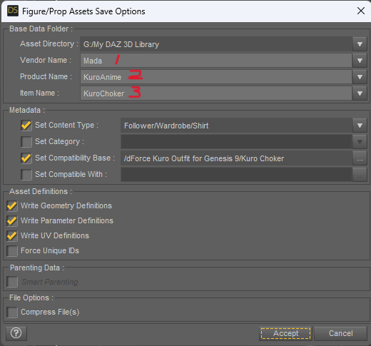

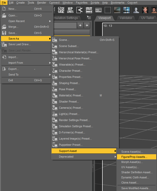

    Select the item in the scene file. Click on File - Save As - Support Asset - Figure/Prop Assets
    Fill in any name in the save as dialogue to get to the Save Options window.
    In the Figure/Prop Assets Save Options popup you will see the Asset Directory (the Daz Library where your fille is)
    Vendor name will tell you who made the item (1)
    Product Name will tell you what the data folder is called (2)
    Item Name will tell you what the clothing item name is (3)
    There's a good chance the Compatibility Base line will show the product name as its shown in the store.
    Click cancel when you're done - not accept - all we want to do is see where all the files are.
    520 x 485 - 37K
    612 x 743 - 78K
