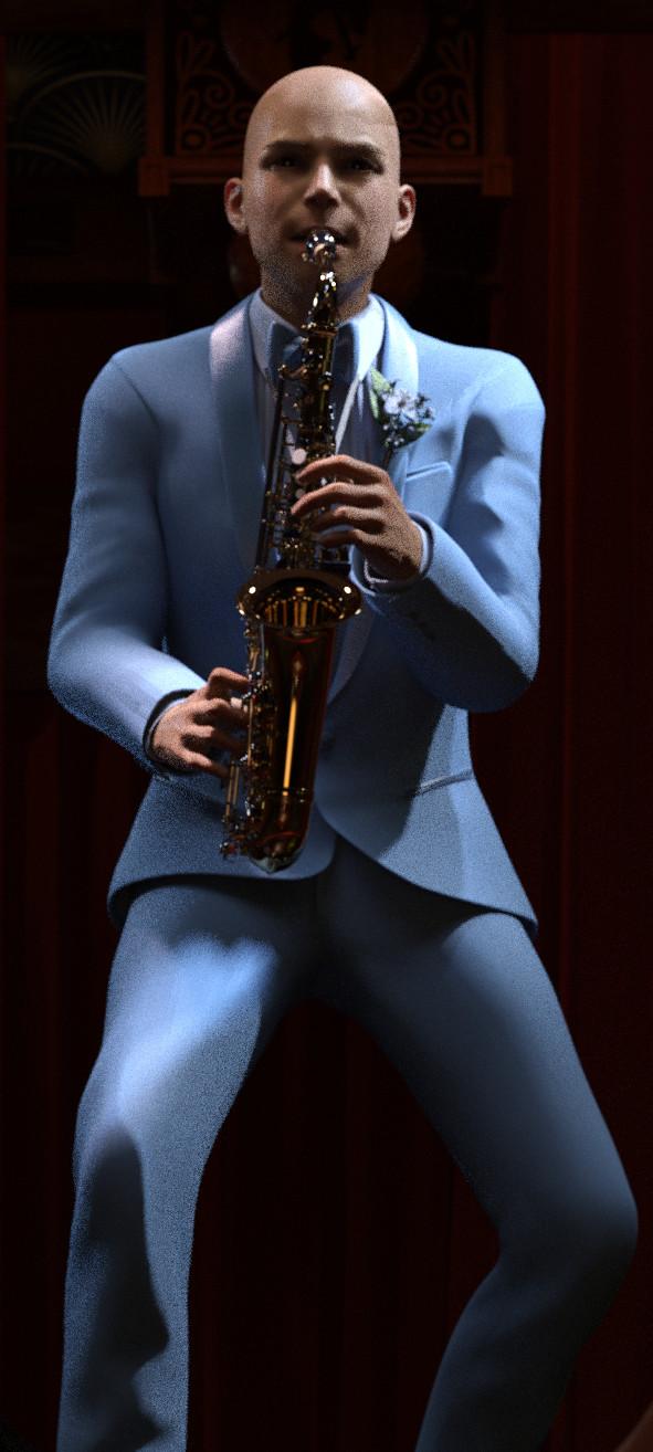

    If you remember, how long did it take you to replace the emissive lights ? Do you have example of renders done before and after changing them ?
    After 10000 iterations, the character at the centre of the stage is still not there despite the whole image having achieved a 99% convergence ratio:
    Doing a spot render only on his face, I think after over 20000 iterations, it was still under a 80% convergence ratio…

  • ElorElor Posts: 3,428
    edited January 2025
    Removing everything I didn't need from the scene subset I loaded (no idea why the strip neons are loaded with the cabaret preset), then disabling the emissive surfaces that both survived the process and were not visible in the render frame did wonder to the rendering process. It's now way faster and that guy on the stage is far less noisy:
