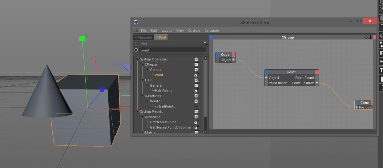

    I need to attach an object to the tongue.
    Use Xpresso to attach the object to a point  on the tip of the tongue
    https://www.reddit.com/r/Cinema4D/comments/3a2zei/how_can_i_attach_an_object_to_a_point_on_a_mesh/
    1244 x 545 - 52K
    Post edited by wolf359 on
    It is one of the things I did, the problem is that xpresso does not follow the rotation, I need that when something is attached to a polygon of the mesh it is in position and rotation.
    that is, if you stick something to the mesh with xpresso it would work like the seats of a ferris wheel, they follow the position but at the end they do not rotate with the axis.
  • GordigGordig Posts: 10,668
    I'm not the handiest with XPresso, but if you attach an object to a polygon, can you not also align it to the polygon's normal, and thus follow the rotation?
