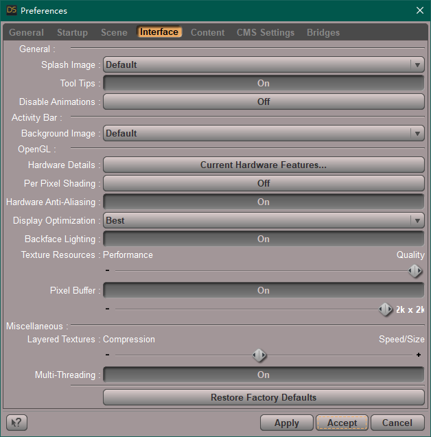

Hello guys! Please, excuse me if my topic is not on the right place. I have a quick question, so my DAZ is extremely laggy in viewport... like EXTREMELY. It's not possible to move around and pose characters or something you know. I'm working on DAZ Studio 4.21 Pro and my PC is -

I have watched other forum posts about this topic and yes - I have tried Edit/Preferences/Interface/Display Optimization to Best and Anti-Aliasing. It is still the same. I have also tried to reduce characters Mesh Resolutions... Simply don't know what else to do. It's hell to work like that. Thank you in advance!

     And, you'd better post a screenshot, with Draw Settings pane activated...
  • As I mentioned before, the SubD of the characters, hair, clothes etc etc are always on 0 when I'm posing them. I haven't really touched the Draw Settings, so here is a screenshot of it -
    437 x 396 - 20K
