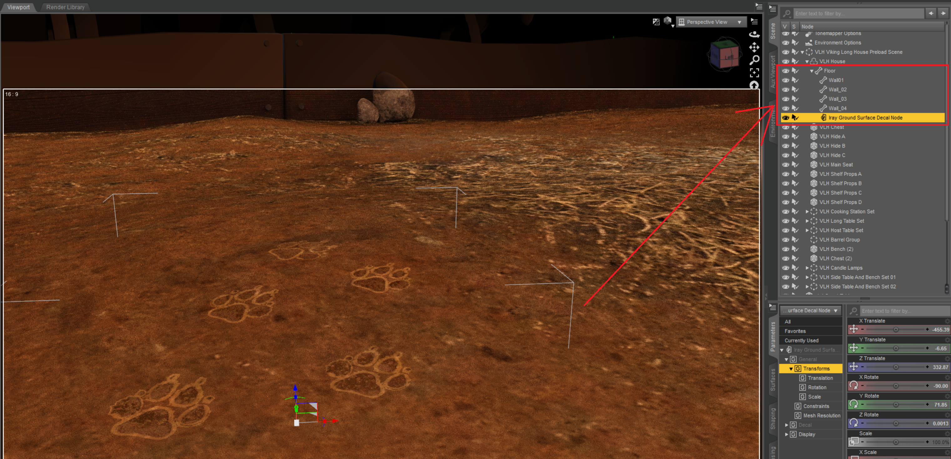

    Did you make sure to move the prop to the plane or floor? The ground plane needs to be the parent object in the scene for the footprints to show up in iray preview or render.
    paw prints
    Added a picture of the Iray ground Surface Decal Node under the floor node (so floor is parent). You also need to make sure the bounding box is around midway through the floor for the prints to show up.

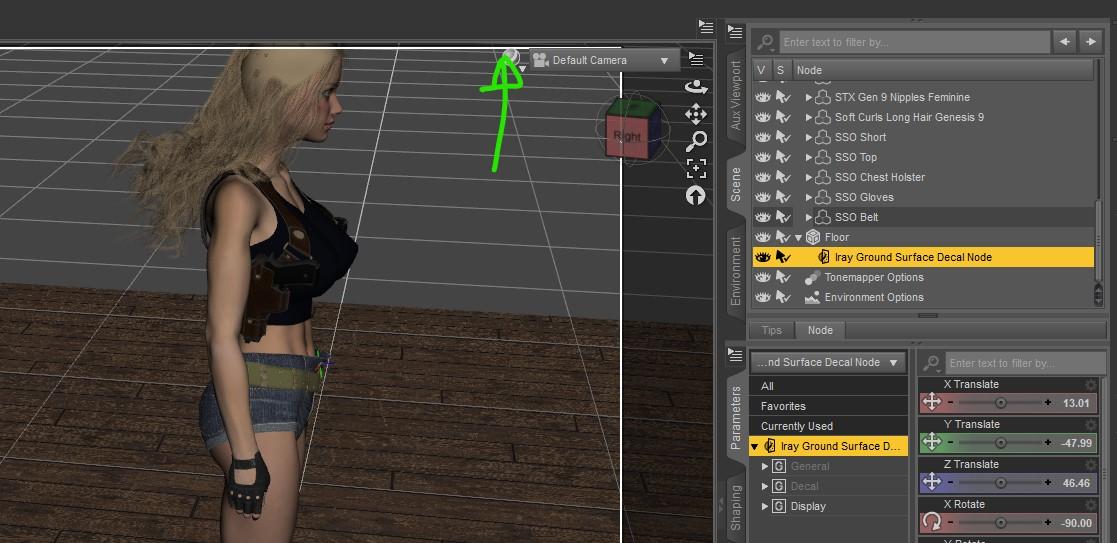

  • GordigGordig Posts: 10,624
    You're in texture shaded viewport mode. You need to switch to Iray Preview to see them in the viewport.
  • how do you do that
  • MelanieLMelanieL Posts: 7,756
    edited November 2023
    Click here:
    This should drop down a list including "Iray Preview" (as I recall)
    1117 x 543 - 148K
    Post edited by MelanieL on
