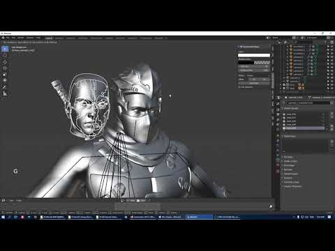

    Haha, let me refresh my memory by reviewing this tutorial from him first... cool
    Edit: urh.. a long one, I don't remember if I ever watched this tutorial, but I assume if he "fitted" the armor by driving bones... If so, why didn't he use sculpting tools... Let me quickly check...
    ...Yes, that's right, as that armor from a game asset with FBX format, then Kelvin used bones to "align fitting". You don't have to do that !  You just need to use Grab, Draw and Smooth brush in Blender to quickly tweak the sleeves to fit on G8M. It may just take a couple of mins ( try using Symmetry first !)
    And the XYZ translation values of the robe in DS are not correct, they have to be all Zero. You should export and reimport obj before transferring rigging, or well align the robe with G8M for fitting in Blender.
