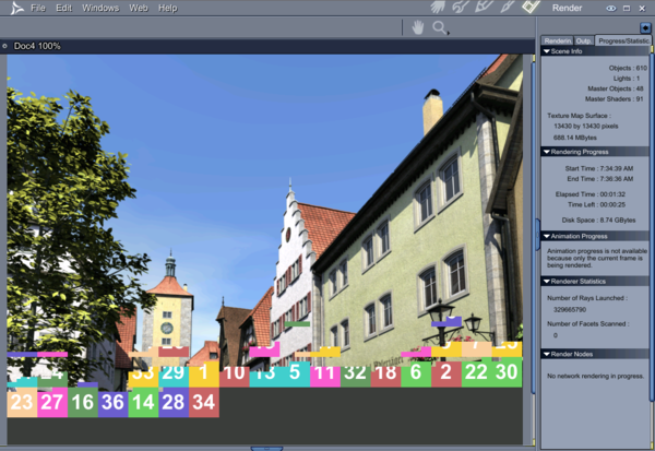

    protovu, If there is a limit on cores in a single box it's pretty high.
    1016 x 700 - 562K

    Hi Stringtheory9,
    Now that is an impressive image. Thank you for posting it. Technically, perhaps you can clarify what I am seeing?
    First of all, is this a Grid render?
    Is there some advantage to using Grid when on a single machine? ( the Grid description page seems to allude to this).
    If anyone knows: The Grid page is really lacking in information. I would really like to know more. Does each machine require an instance of Grid, plugins, etc.?
    If using, say, 3 machines, is there any advantage over Carrara render nodes?
    Thanks,
    R

    I think it's just a regular render on a computer with a large number of processing threads. I see the same kind of thing on mine, and I've just been using the out-of-the-box render settings.
    (Mine is a Z820 with dual Xeons, 24 threads each CPU)

    It's one machine running two of these bad boys. I plan to get Grid as I get closer to rendering my project but for now I can't give you much insight on it.

    So you're running two VERY expensive 18-cores Xeons, with hyper-threading that means that you have 72 logical cores or nodes. Am I right? So, without the Grid, as I can judge from your pic, you are limited to 34 cores with one machine?
