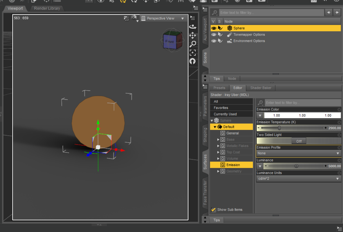

How do I see the emissive effect created?
I wonder why I could not see any emissive effect on this sphere under the current set-up?

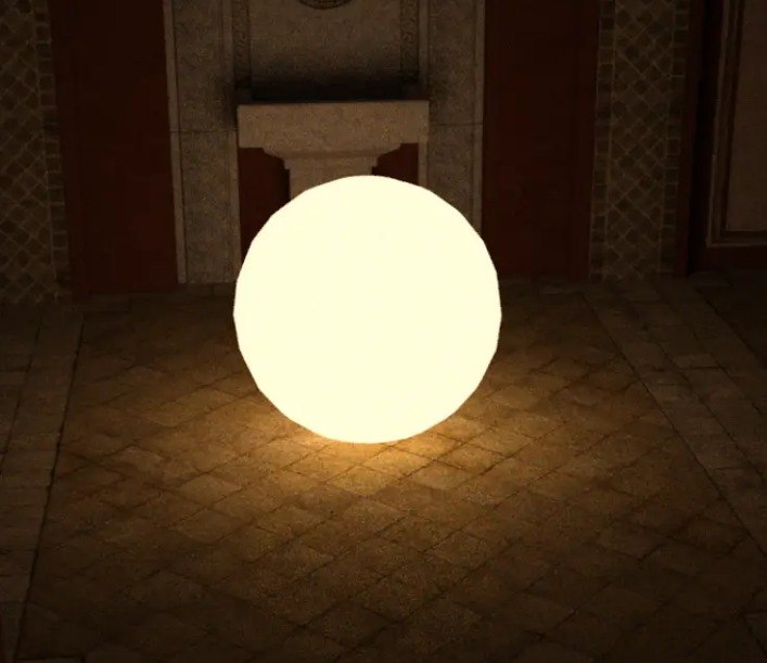

Actually, I want something like this:
So how can I achieve this?

    Your luminance is quite low. Change it to kcd/m^2 (1000 times brighter) or cd/cm^2 (10,000 times brighter), or another setting, and/or adjust the Luminance value. You could also try lowering Exposure Value in Render Settings (changes the whole render, not just the light).
  • crosswindcrosswind Posts: 9,681
    Luminance value is too low, give it 50K or more, and you better place a floor there otherwise  it's not really apparent with no reference or reflection. Add some Translucency as well.
    1910 x 1393 - 2M
  • FishtalesFishtales Posts: 6,219
    Try turning the light that is coming from the right, causing the shadow, off.
  • GordigGordig Posts: 10,650
    An environment helps to sell the luminosity. The effect you're after is demonstrated in a dark room with objects for the light to illuminate, while you're currently working in an empty void with an HDRI that is overpowering the emissive effect.
