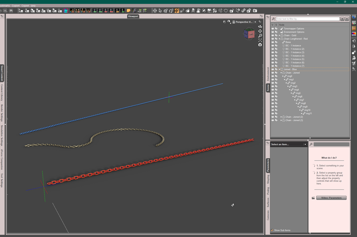

    OP probably meant the distortion of shape rather than texture when scaling... If so, better name the product or show us an SS.  Depending on the prop, there might be a way to lengthen it... like the one as below, by joining and hiding...

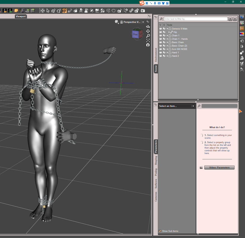

    Sorry for the misrepresentation, it should be that scaling Z causes the shape of the prop to change, not the shader. It's a problem like the image below. I have this problem with my other belt. sy's post does stretch infinitely, but I think his rope can't do same thing

    OK, chains will be much easier... usually 3 ways to lengthen the chain: 1) create instances 2) join one chain to another and duplicate them as you wish 3) make one by yourself (not necessary as you have no way to make it 'infinitely lengthy' ). You should find a chain prop with multiple bones, that'll be very easy for manipulation.
    Besides, for the similar case like 'superhero got chained', as long as you have a chain with segments (multi-joints) or with dForce, and some patience of course, you can get what you want... Or using some product may be also fine.

    I have followed your approach once, please see if I am doing it correctly. 1.I made a direct copy of the chain by clicking directly on Create - New Node Instance, and then ds made a direct copy of the chain, but it's just a solid, no skeleton (my chain has multiple bones)it looks not good for adjusting
    2.(copy)Duplicating the chains directly and then ds gives me exactly the same chain, which I usually find the most convenient when very complex transformations are not needed, but once very long lengths are needed, duplicating them one by one is also time consuming, and the duplicated new chains are in the same position as the old ones, so I need to adjust their positions every time
    3.So I just connected two chains together, and then connected the parent of one to the other, and then clicked on copy, so that I can just copy a long chain with bones, (I'm not sure if I need to change the parent, I think ds will just copy one of them if I don't) By doing this I can just copy three or four longer chains out
    如果你不想自己制作链子,就用些更好的链子,你用的这条也太短了,可不是要复制很多次咩~  我之前贴图里的那条,一百三四十个环,rig得也很不错,复制一两次就很长了。。。 若希望用链子给姿势,有常用技巧,可私信
