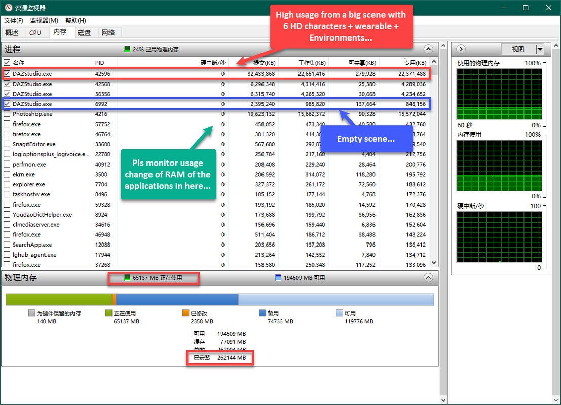

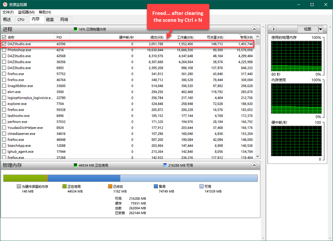

    Hmm...do you use multi-instances of Daz Studio, and have you checked the RAM usage status with Resource Monitor ?
    I've been using multi instances of DS for 2+ years, 3 - 4 sessions opened at the same time at least, have never met RAM leak from DS. The increase of RAM consumption mostly come from big / complex scenes (esp. there're many high SubD objects, LAMH, SBH,  dForce items with simulated results, etc...) , as well as other big applications, e.g. Photoshop...
    I have 256GB RAM, most of the time the usage is always under 30% (less than 70GB) though I work on big scenes. After closing DS sessions completely, RAM will be freed with no problem. BTW, I myself haven't found any issue from 'killing DS process' (thousands times at least), as well as cms as I'm an in-depth user of PostgreSQL.
    So, pls monitor the status of RAM usage and release with Resource Monitor (may open it from Task Manager), see if there's any problem after launching / closing DS and clearing scenes....
